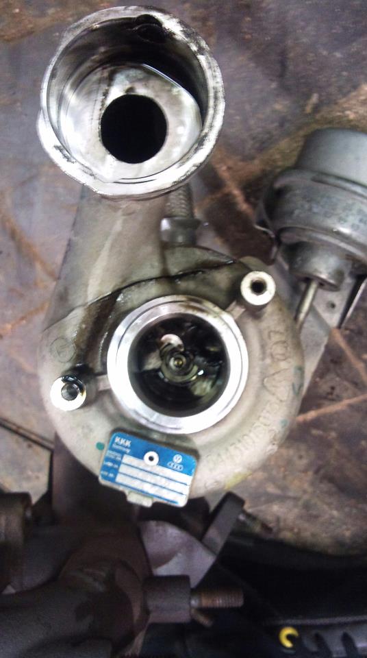

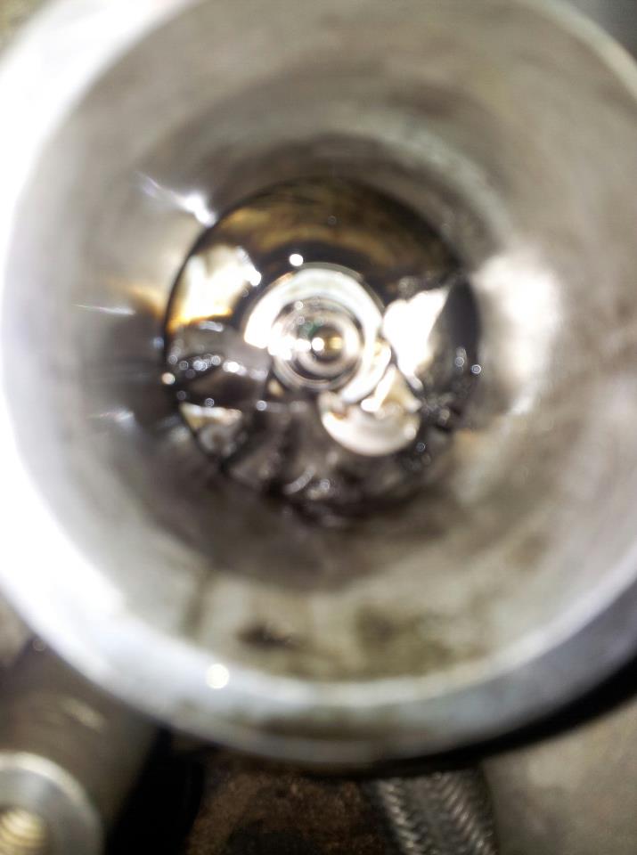

when the turbo went it shattered the compressor on the inlet side. my intercooler is full of oil and when the drained the oil its full of metal so everybody ive spoken to said strip, clean and rebuild it to be on the safe side so i dont score the cylinders. ill add a picture to this post of whats left of my turbo.
aw never this is the same as mine intercooler was full of oil and bits. I have yet to drain the oil though. How far have you gone with the strip down as in what have you removed?

Looks a really nasty break up on the cold side :(
