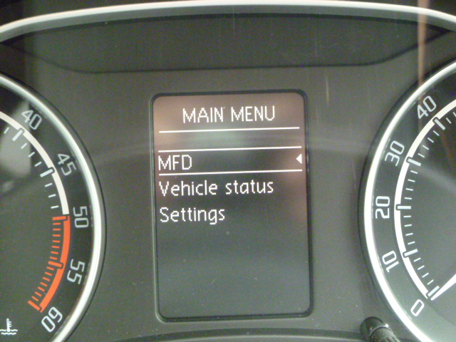

I had a Bolero fitted as standard along with Maxidot and I am sure I had a few options (Audio for 1) to have things showing on the Maxidot display.
I have since changed the Bolero for a Columbus (and had it all coded to work - thanks Donovan), but now the extra options are not there (that I can find anyway)
On pressing the Maxidot button I only have
MFD
Vehicle Status
Settings

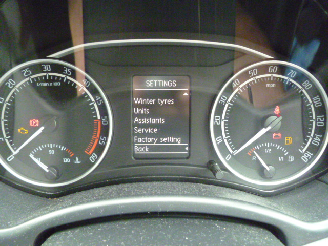

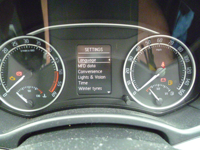

Then when entering the settings option, there is no option (that I can find) to have anything else other than the MFD Data to display on the Maxidot screen.

The problem here is with the coding of the bolero / columbus
pre Face lift make sure BAP is not coded
for facelift cars with white dials BAP has to be coded
also Shortpress may need to be ticked or un ticked
