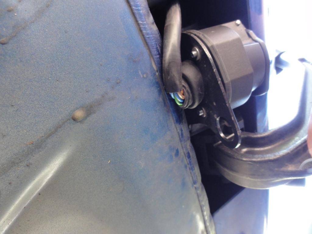

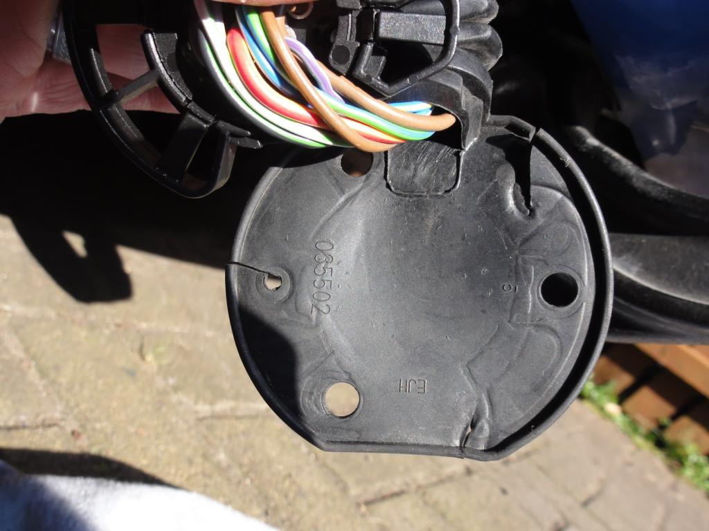

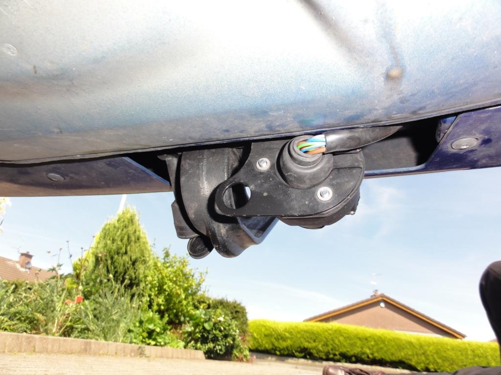

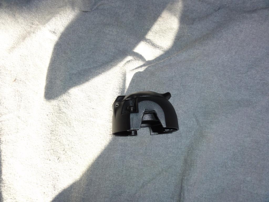

The story is as follows: I paid for the factory fit wiring box to be fitted to make it easier for me to fit the bar. I have been fitting them on every car I have owned and it was an option ticked when placing the order. I was trying to make it easy.. for me to do the fitting. Turned out, the dealer offered a detachable bar as part of compensation package, so they organised a professional mobile fitter. The only word not contravening the trades’ description act is mobile. The first attempt let the socket unusable as it was fitted reversed and the door would not open to accept the plug. He butchered the socket cover and also the rubber seal on the socket, this was discovered after driving a fair distance to collect a trailer at night - no lights = points and fine. Sent pics to dealer, spoke to dealer principle and had words with service manager. On second attempt, the master butcher cut the official wiring at the socket and installed a standard rear entry socket leaving the wiring open to the elements and removing the ability to swing the socket up to make it invisible. All was sorted when the dealer looked at what was involved and replaced the wiring from box in boot to bar. That left the coding, which looks like they have screwed it up for the third time( they were supposed to do it after the master butcher did his work).
