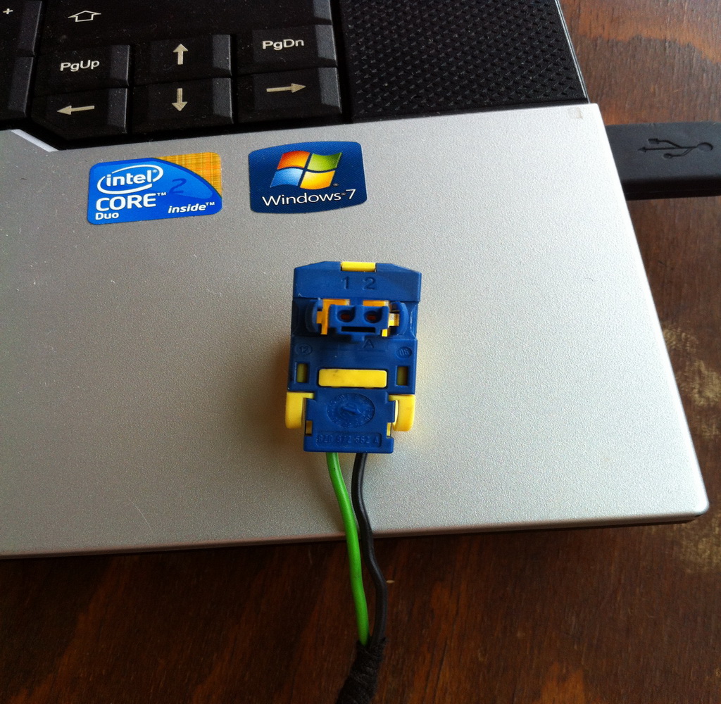

octavia II sedan from 2006. yes, one end of the wire go to ground point in rear compartment, on pillar c: one on the right and one for the left.
but the end for airbag don't know were is connected. i attach apicture with the connector for airbag. It is visible the 2 wires 1 and 2 but is none for groud
The ground wire is a screen - it does not go to the connector.
The ground wire usually has a ring on the end and is secured to the airbag unit with a screw.
ok, thank you very much
