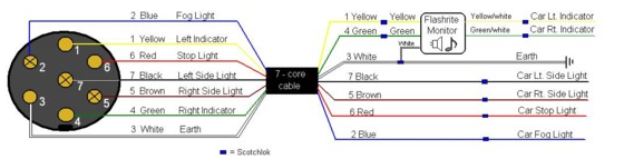

OK, Ive got a wiring diagram off the net, just a bit confused as to where the buzzer would go:
as the diagram suggests, it just goes between the wires for the indicators, and then earth it to an earth point.
From what I can work out it goes a bit like this:
Indicator on Left of car -----wire----- buzzer-----wire-----------to rest of 12N wiring
Indicator on Right of car ---- wire ---- buzzer -----wire -------to rest of 12N wiring
                                            |_______earth to car body
Have I got this correct?
