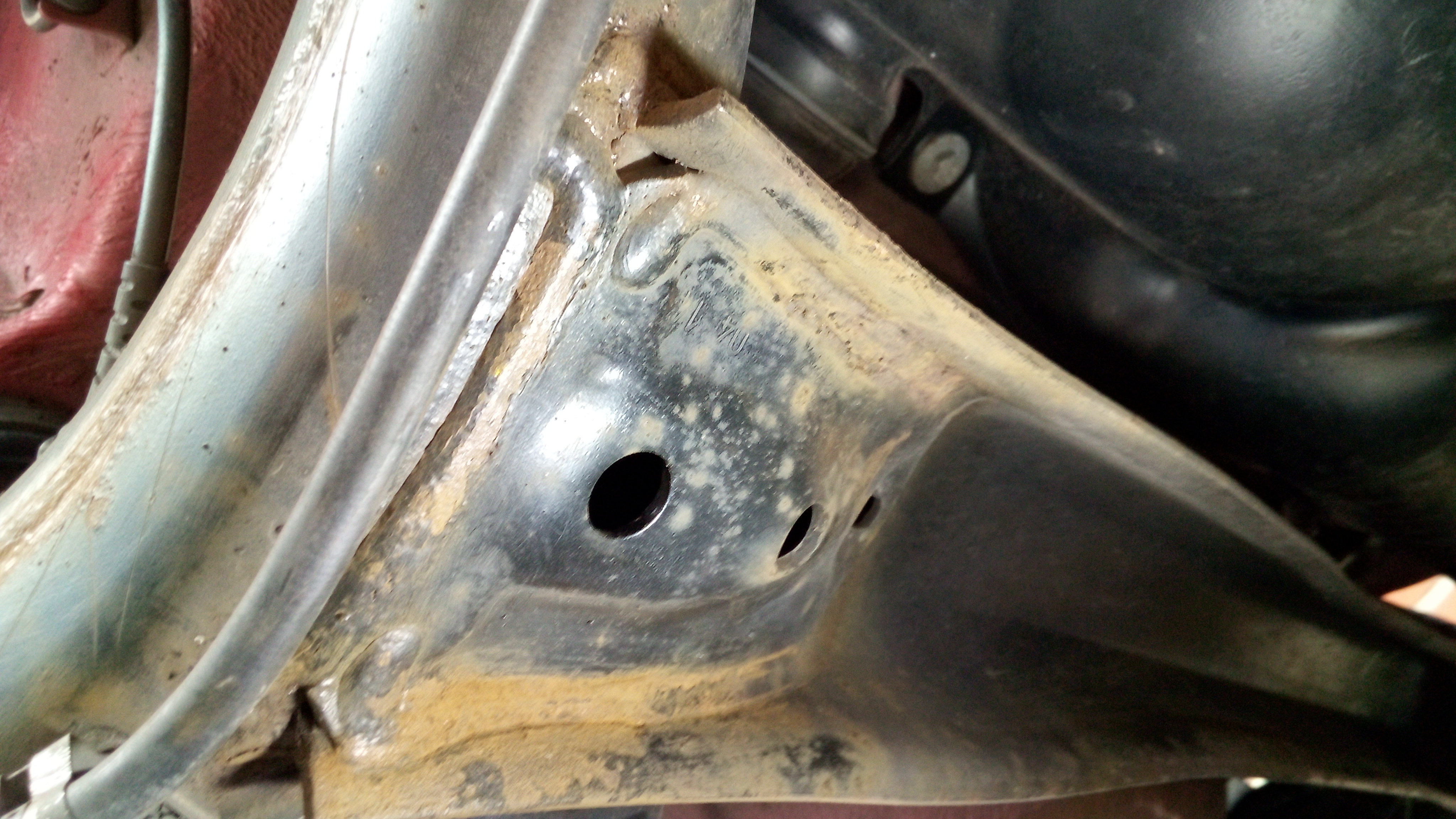

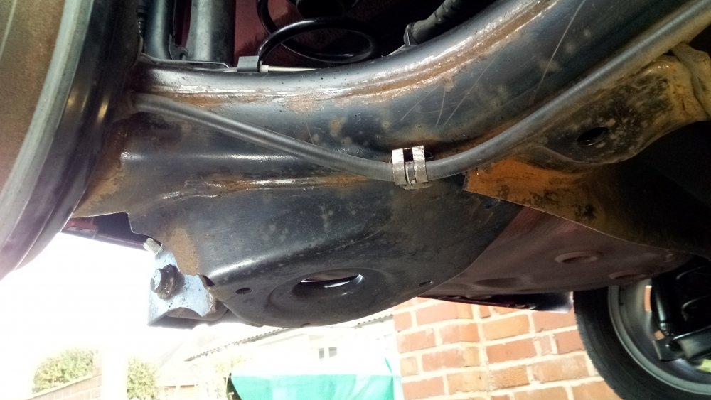

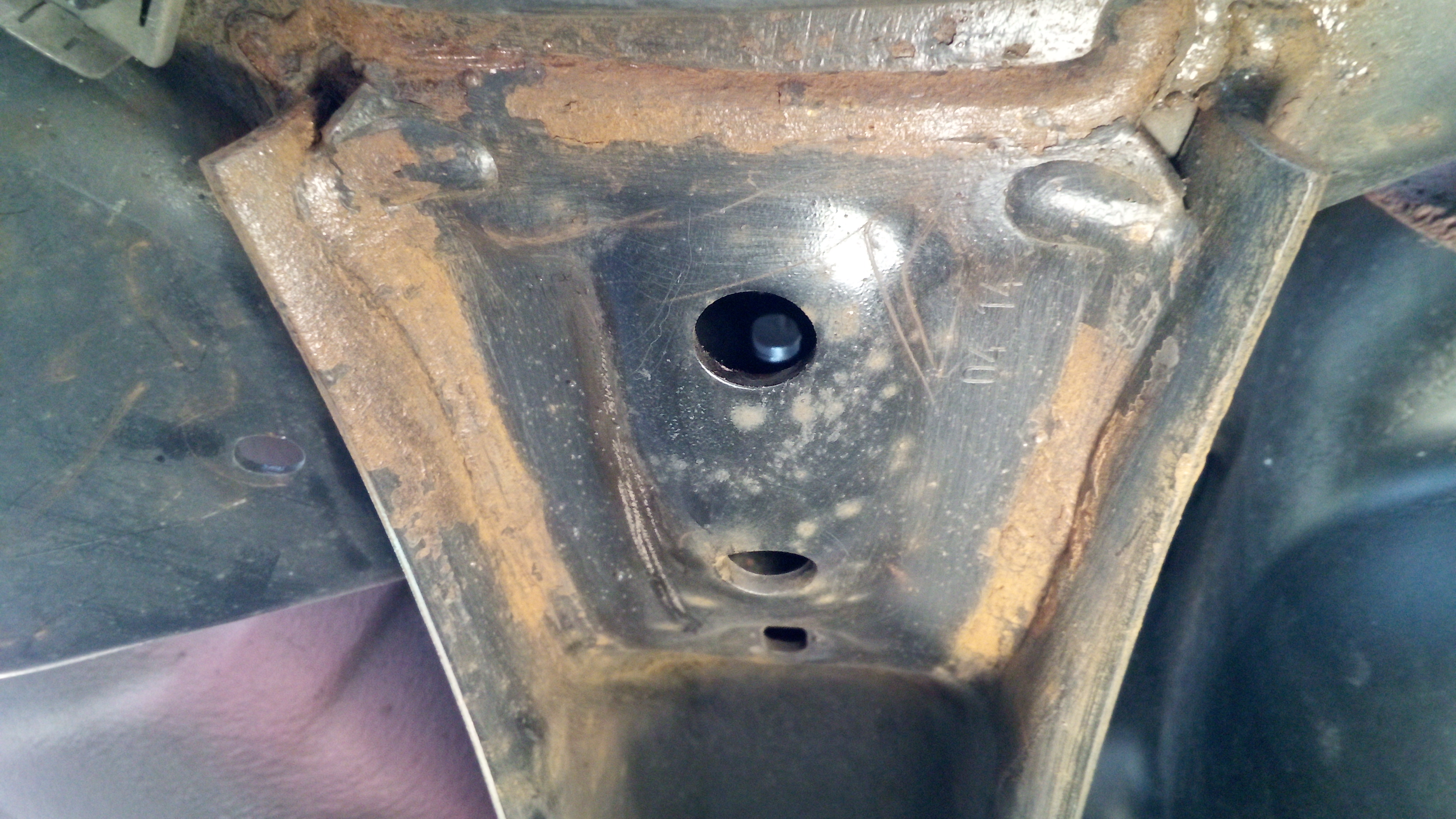

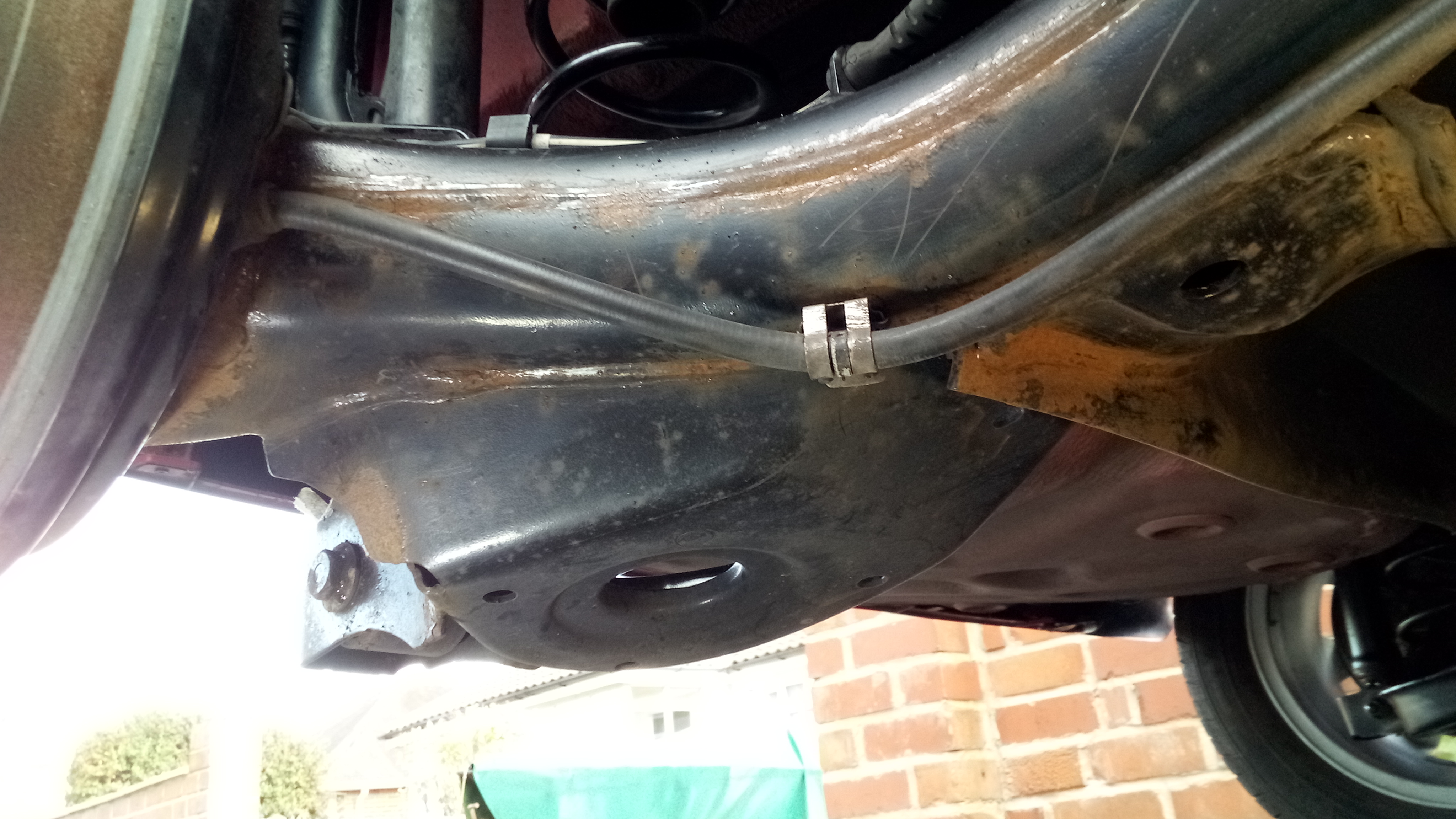

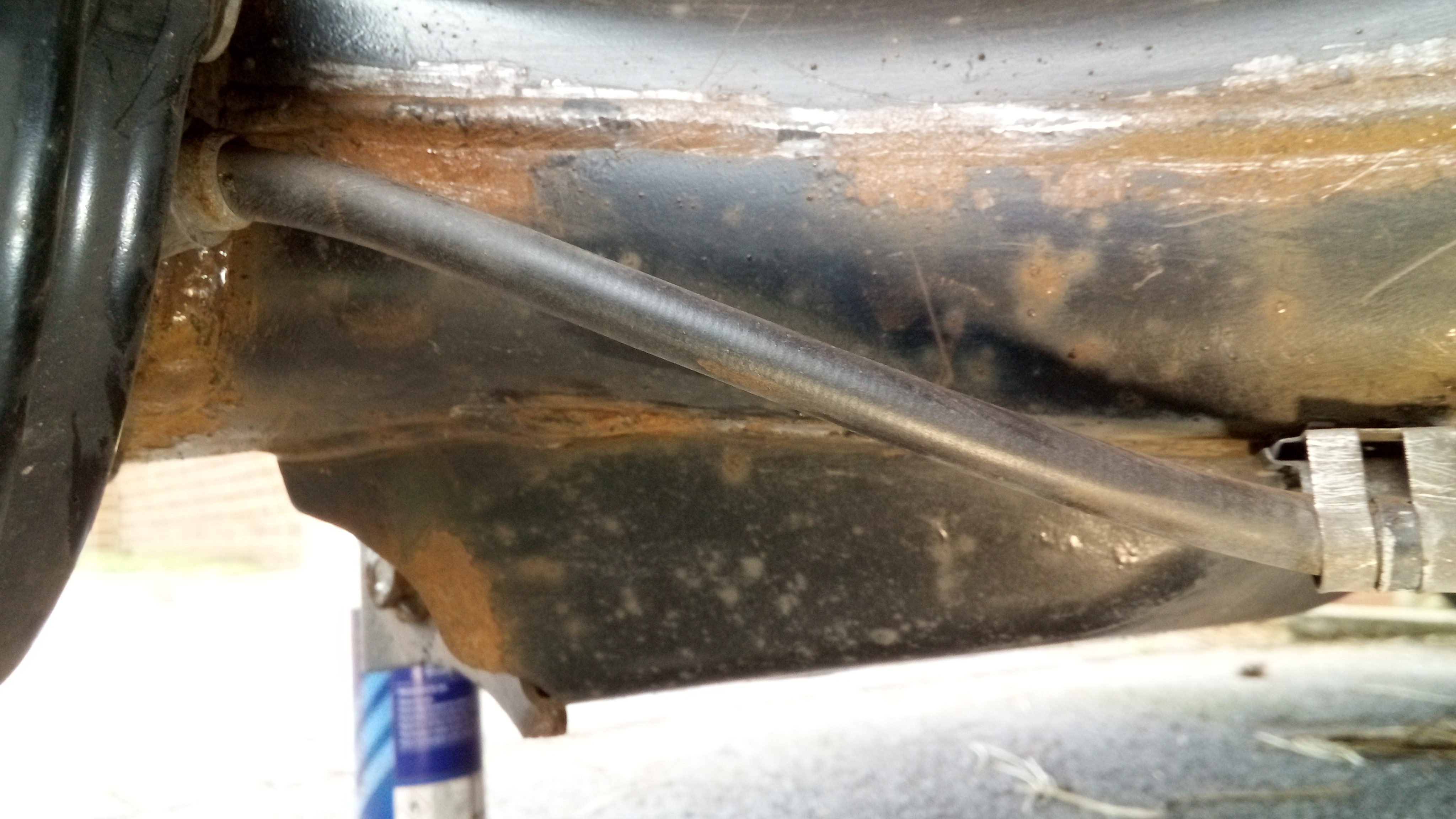

Last week I was fitting rear wheel arch liners on my 2014 Citigo (see relevant Briskoda thread) when I noticed some serious corrosion on the right hand side of the rear subframe. The rust is worst along the various welds, where I chipped thick rust scales off, but it has also occurred around the various flanges. The subframe had not been primed or protected in any way - it appears to have been treated with nothing but a light spray of black paint. Given that this severe corrosion has occurred over a mere three years & 19,600 miles, and similar corrosion has probably occurred inside the subframe, I certainly would not expect my Citigo to survive ten years without serious remedial work. I attach pictures below, but please note that it didn't occur to me to photograph the rust until I was some way through removing it (the rust was originally flaking off and much worse looking). I had fitted the left hand side rear wheel arch liner first, but didn't check the condition of the rear subframe on the left so I don't know whether that side is in a similar state of deterioration.
Having chipped off as much of the lose flaking rust as I could, I treated the surfaces with 'Loctite 7503 Rust Remedy'; when dry, I sprayed the area with Dinitrol ML, and will follow this up with one of Dinitrol's underbody waxes. I have also found my old spray extension and, if we get a spell of warmer weather, will spray inside the subframe.
