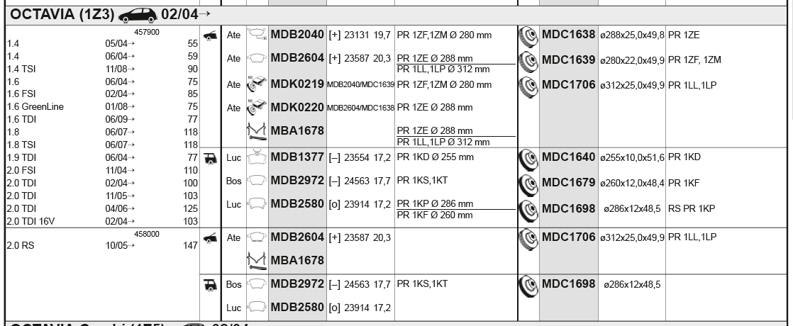

Every website I've been on this last week looking for rear discs for my vRS TDI has listed the size as 266mm.
My car is fitted with 286mm rear discs.
I assume all vRS's have 286mm rear discs?
Mintex catalogue has all vRS as 286mm rears and 312mm front
the FL vRS tdi has solid 271mm rear discs the same as the mk6 golf gti
so the Mintex catalogue is a bit out of date!
sorry its 272mm :blush: 1K0615601AA
Either way, Mintex still say 286mm
Mine has 286mm. Fitted them 2 nights ago :think:
