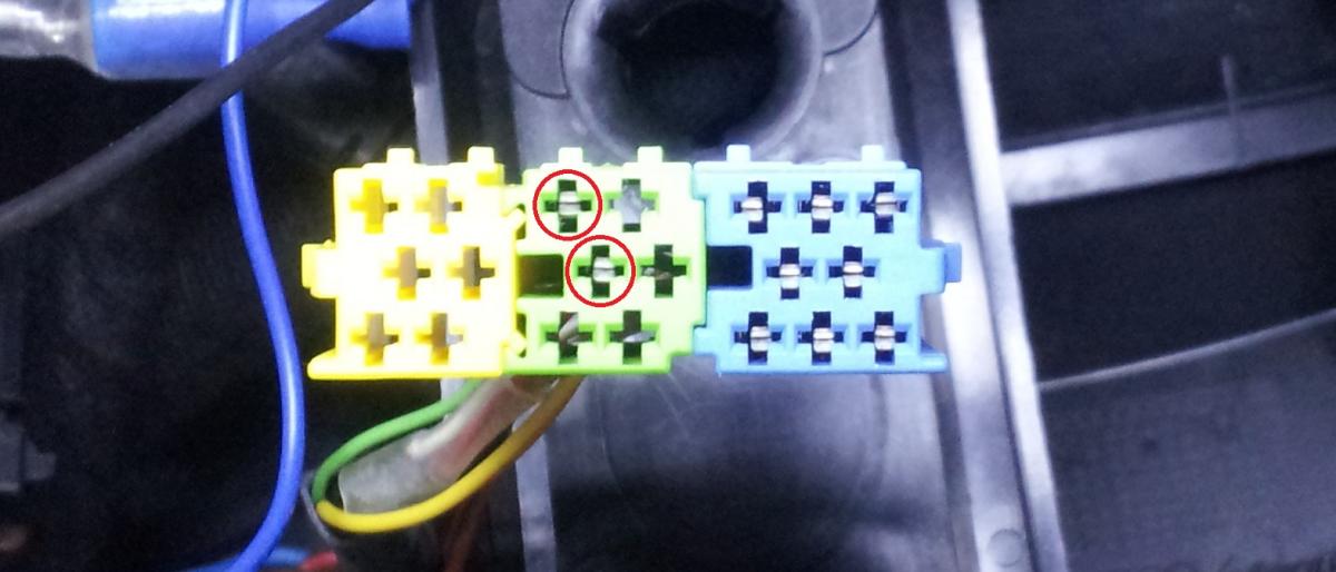

I've just installed a Pioneer AVH-4400BT stereo, along with the autoleads steering wheel adapter in my 2004 Superb Comfort 1.9 TDI (non-CANBUS). The issue that i have is that the adapter doesn't pair with wire in the car adapter.
I've spoken to Dynamic Sounds, where i bought the stereo, etc. from and they confirm that the harness is correct for my car, and that they don't have another option - which having looked at the ISO PIN thread, appears to be correct, (Block C2, Pin 11 = Steering wheel control). However my car seems to be different, my wires in the C2 block are Pins 7 & 9, circled in red - although the actual shape of my block appears different, with the 'wings' at the opposite side of the plug. Pictures attached as proof! :) Any advice would be greatfully received, whether there is an adapter available or if the one i have can be modified to work, and if so which pin to hook up to.

yes it worked fine, spoken to a couple of other specialists and still struggling with the adapter to the car plug- doesn't seem like one exists... :wall: Also, checked on ElsaWin and according to that the plug in the car should be as above. *confused* :S
Hi. Yes that's the one i have. It seems to be the generic VAG layout - still can't find anything on the 'alternative' layout that i have and whether it's the standard Superb layout or an interim layout before the CAN-BUS block plug. :(
