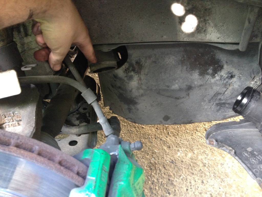

Hi m8, is this still happening? if so you can unplug the MAF to see if that's the issue, have you checked the charge pipe at the back fo the engine that connects to the pancake pipe - older versions of these are prone to leads, you will probably see oil on the pipe if it's leaking. Once you have all your pipe work done, if you're still seeing this issue, it's probably worth bringing it back to the chap that mapped it and have him tweak it a bit.
Is this the pipe in question cause it's the only pipe I haven't changed(to silicone) yet as it wasnt included in my Boost kit I ordered with creation. When I was changing the pancake to ic I noticed there was a lot of oil build up in it.
Do you still have a vac pipe going to fuel pressure regulator on fuel rail as one goes to dv and other to the fuel pressure regulator
yeah that's the one, I think the part number for the updated one is 06A145790C
