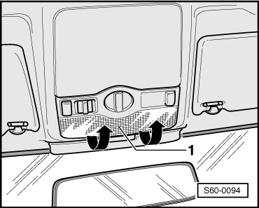

– Remove light covering -1- in -direction of arrow-.

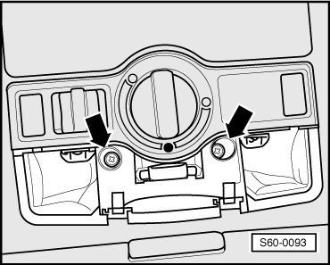

– Remove screws -arrows- and remove the lamp with rotary switch. – Disconnect plug connection from rotary switch and remove rotary switch from the lamp. – Place lamp down to the side. Continued for all vehicles – Remove trim panel of pillar B top <a href="vw-wi://ctrl:idref=idadghre/" id="IDADGHRE" idref="x-4nx0nrkqvl">? Chapter. – Remove door trim panel from the top of pillar A ? Chapter. – Remove trim panel of pillar C above ? Chapter. – Pull off the trim of the sliding roof opening (only for vehicles with a sliding roof). – Removing recessed handles ? Chapter. – Loosen the cover strip -3- downwards and pull away from roof frame. – Removing sun visors ? Chapter.

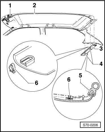

– Remove plugs -4- with special tool -MP 8-602/1 -. – With the assistance of a second mechanic (risk of fracture) lower the moulded headliner -2- and remove from vehicle.

Note t Before fitting the cover strip -3- pay attention to the correct fitting position of the clips -6- . t A spacer -1- is stuck to the front side of the moulded headliner (on vehicles without tilting roof). t
Pay attention to the correct fit of the seal -5-.
