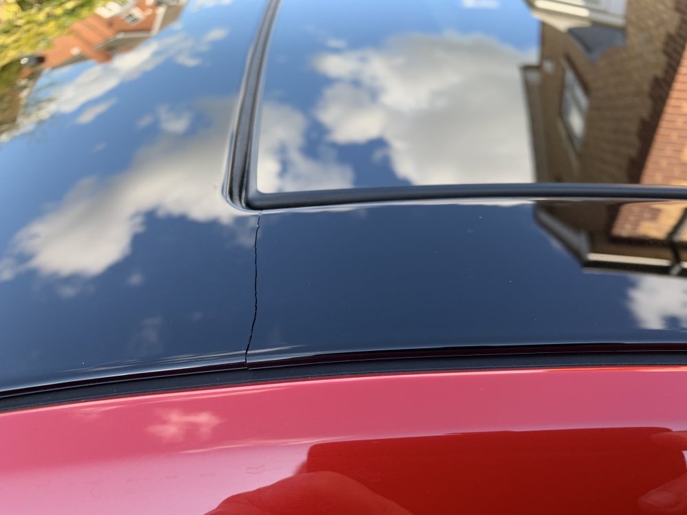

Glass roof cracked
I just found a crack in the glass roof, not in the actual sunroof. No stone hit etc. I hope this is covered by warranty. :sadsmile:
If not I wonder if it would be covered by car insurance with the replacenent window cover so you would generally pay less excess and not affect no claims??

Wow I wonder what caused that !! Can you remember hitting any bad pot holes ?
I live in hope ..
No not any  let alone a bad one. The dealer should be able to see the wheels and suspension. Curious myself to find out.
Must have been a pre existing fault maybe the recent cold weather ? ...... Hope you get it sorted !
Edited by Nick_H
Don’t let them tell you they’ve never seen it before. I’ve seen some that exploded while the car was being driven. You should find some more info with a simple google search.

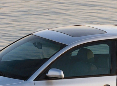

Just trying to understand this:
So that's a crack across the STEEL roof, between the glass sunroof and the roof edge.
is that right?
I have a panoramic rood in my wagon/estate/combi and it looks a bit different.
I assume this is a sedan/hatch like here where the roof is black:

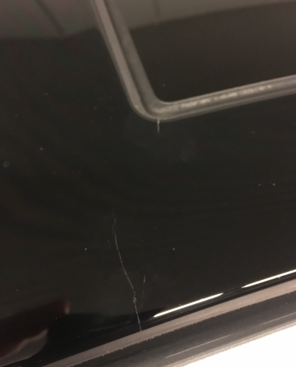

Mine cracked in the same place (sedan black panoramic roof). The dealer did not want to cover it through Skoda extended guarantee.
@Redboy You'll be lucky to have that covered by a normal policy. Mine specifically disallows panoramic roofs.
Just curious: have you used a roof rack or otherwise put any stress on the roof?

No, nothing like that. However, I got a panoramic roof serviced three years ago - it did not close properly from inside. The car is in the garage through cold nights, so cold is not a factor here. Maybe now I will try again with Skoda Service - if there are two cracks on the same spot, this could be something they need to fix.
is that right?
I'd like to know the answer to that, looking more carefully at the photo I dont think it is glass or steel judging by the crack, plastic or GRP perhaps?
Aside from the lunacy of having an entire glass roof I dont think it could possibly have the radiused edges and seal retaining grooves that the one in the picture has.
is that right?
It’s the hatchback and yes it’s the glass surrounding the sunroof

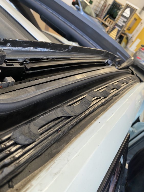

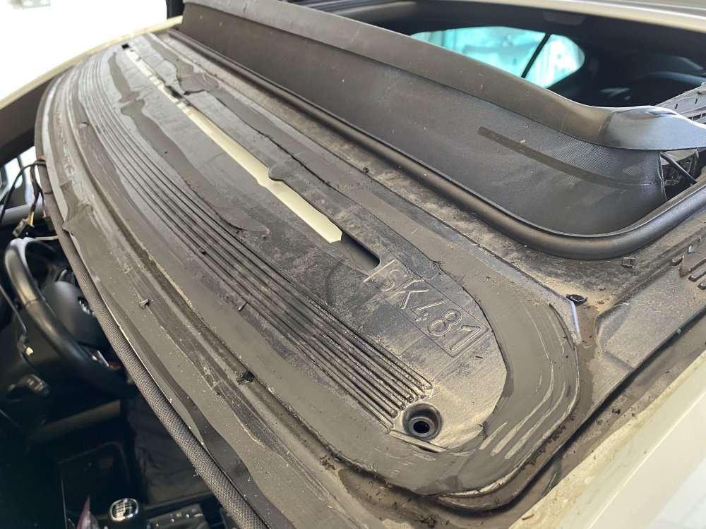

It’s plastic and it’s easy enough to remove by competent windscreen fitters and the new one just bonds down using the same sealant used to bond in a windscreen.
It is a pretty easy job really, it’s just a plastic surround.
I have pics of one removed. Guys car was parked near someone that was welding and he got spot welds all over his car. Entire repaint and every glass and sunroof replaced.

Thanks to all helpful contributors especially for the link from Bigeater and Ajamesr photo. The link shows that this is a common VW fault, which is the same design.
Update: I dropped the car off at a VAG group approved bodyshop  this afternoon, after collecting the roof cover and various tubes of glue from Horton Skoda of Lincoln earlier today. The box just fitted inside the hatchback opening. Apparently they plan to drop the headlining and leave the windscreen in place, thus no extra squeaks should come from the dashboard or camera alignment required. The Suzuki Swift hybrid courtesy car did 72 Mpg, lots of gadgets but no cruise:blink:. Bit plasticky and noisy on the road and no torque or power to speak of. Apparently it’s actually a Toyota Yaris. I will probably put a final note on this sorry story in a few days
