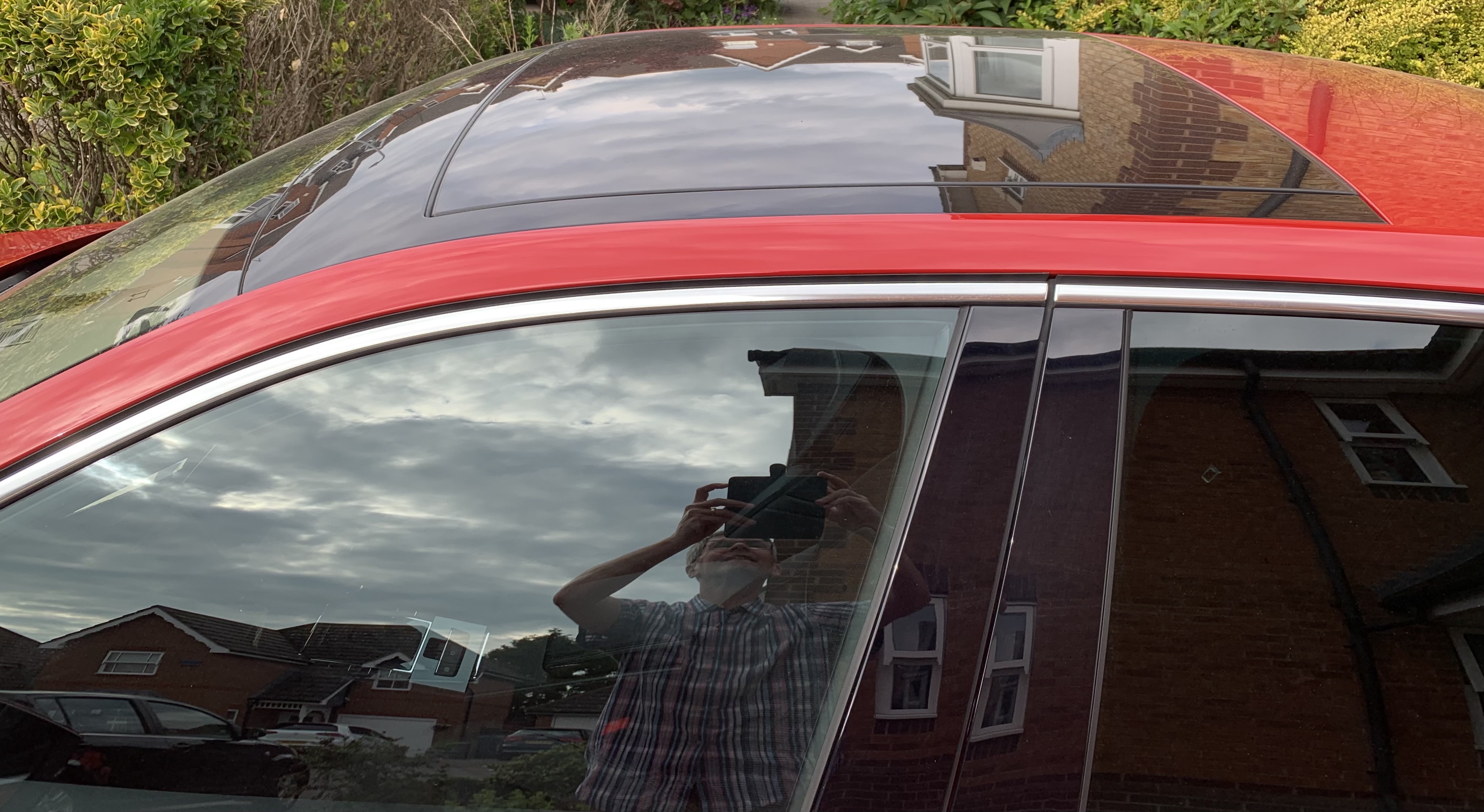

Nothing dropped on mine, it is a stress fracture, identical to those suffered on VW cars, particularly Golf GTI. Is your NCB under threat because you  have made another claim. I always ask for NCB protection.

For @candasmand @Andrei_Spataruthe dealer stated they weren’t aware of any similar cases and needed to inspect the car on a ramp (probably to check if I had hit a pothole or something which had caused the split in the roof) No visible cause or reason was found other than it just split. So it was repaired at an approved bodyshop under warranty because the car was under 2 years old.  Check out US VW Golf Mk7 website and there are a lot of pictures of similar cracks on Golf GTI on each side of the front edge. The crack shouldn’t leak into the car as the water should drain into the channels eventually, provided the drains are clear. It looks worse than it is. The affected area is a plastic cover. The glass sunroof itself was not damaged and closed/opened without a problem but it looks bad. You could try sealant but I think it’s a stress crack which will open up again. I think it’s about £1000. It’s not an uncommon fault despite what dealers may say. Good luck sorting it out as Skoda in the UK at least, don’t always pay up with cars out of warranty even for a well-known problem.

@candasm I haven't checked with Skoda service. Talk with a mechanic that I know personally and he said this can be fixed with some adhesive and polished but during summer when everything is dry. Nothing to worry about the crack since underneath is the draining spaces. Its been a while and I haven't seen any leaking issues. All in all is just a "cosmetic" problem.

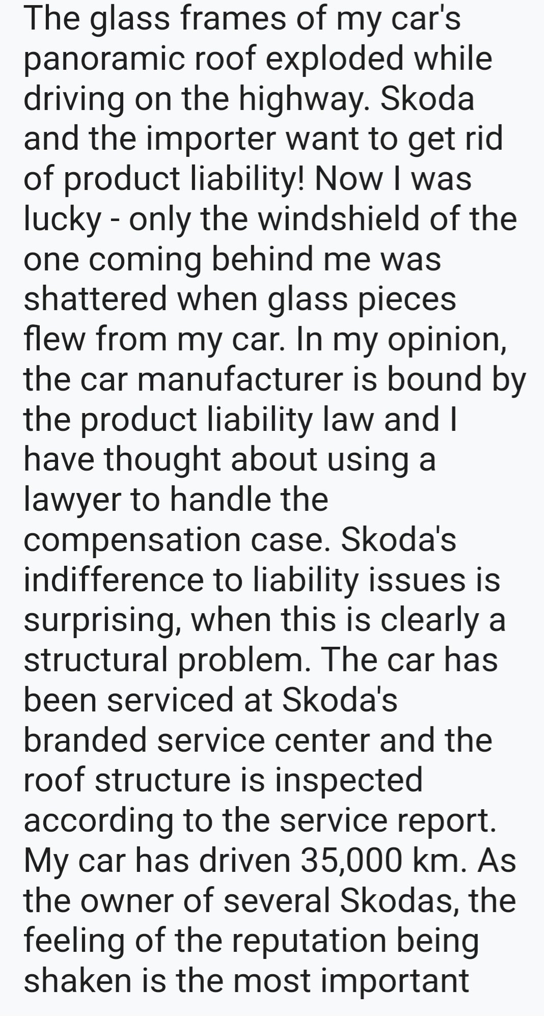

Autoni panoraamakaton lasikehykset räjähtivät ajon aikana moottoritiellä. Skoda ja maahantuoja tahtovat irti tuotevastuusta ! Nyt kävi tuuri - vain perässä tulevan tuulilasi särkyi lasiosien lentäessä autostani. Käsittääkseni auton valmistaja sitoo tuotevastuulaki ja olen ajatellut käyttää juristia hoitamaan korvausasian kuntoon. Ihmetyttää Skodan välinpitämättömyys vastuukysymyksistä, kun tämä selkeästi rakenneongelma. Auto on huollettu Skodan merkkihuollossa ja kattorakenne tarkastetaan huoltoraportin mukaisesti. Autollani ajettu 35.000 km. Usean Skodan omistajana tunne mainekuvan horjumisesta on päällimmäisenä.
Quote
The glass frames of my car's panoramic roof exploded while driving on a freeway. Skoda and importer want to get rid of product liability! Now it was lucky to have a windshield coming behind him shattered as glass parts flowed from my car. I understand that the car manufacturer is bound by the Product Liability Act and I have thought of using a lawyer to take up the compensation case. I am amazed by Skoda's indifference to accountability issues when this clearly structural problem. The car is serviced in Skoda branding maintenance and the roof structure is inspected in accordance with a maintenance report. My car was driven 35,000 miles. As the owner of several Skodas, the feeling of faltering the reputational image is top of mind.

I think this problem is not linked to similar cracked sunroof surrounds.  Essentially once Skoda have sold you the car, it's a long long process to get help even with intervention of Skoda UK. I gave up even with a 2 yr warranty extension and sold my Superb. Life's too short.
