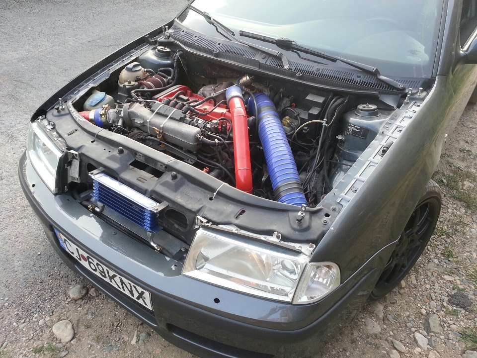

Hy, im from romania, i have on octavia 1998, at the begining was 1.6, now is 1.8t AUM.
From the aum engine i changed the cilidner head wit an agu, and the intake manifold.
I have a KKK k26/27, 044 fuel pump, 720 siemens injectors, front muont intercooler 600x300x10, 3", the throttle body is from a bmw 3.5L (3"), exhaust 3" inox, and the final 4", 50mm bov, emusa external wastegate, induction coil from an e36 1.8i(better spark), vems stand alone, oil cooler, 4" ail filter and the flexible intake, .. and the other i dont remember yet :)
My personal best on 402 m was 13,7 with 2.61 60ft and 178 km/h end speed. I need to learn the lounches, and the track, was very very bad. On a good track e hope 13.1-13.3
I didn't put my car on the dyno, but i estimate 350-400 hp, 1.5-1.6 Pressure.
In the future i want to change the rods and the turbo exhaust part, because its small, and my egt (exhauste gas temperature) reches the 1000 C degrees at the 3 gear at 7500 rpm.
BBS RK 17" WHeels, KW InoxlIne V2 coils.
The nex step is to make a little bit clean under the hood :), the big brakes:)

Would I be right in thinking the stand-alone ECU is required to operate the BMW induction coil, or could you have hooked it into the bosch ECU ?
wow standard rods !!! eeeekkkk
love that pic ;-) can i order one of her please
The sock vw induction coils are bad, they broke quickly and they have small spark. The stand alone was chosen from the first time, because it safer.
The bmw induction coils was chosen at the moment when we start the engine :).So no more problems with the induction coils in the future. This was my wish to put stand alone. :)
