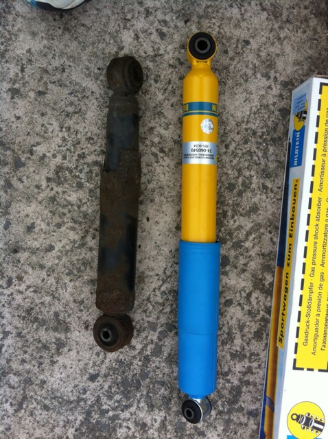

Ride height on the 4x4 is because of the springs. The front dampers are the same but the rears are different due to the 4x4. Are you looking for standard dampers or slightly uprated? If you want slightly uprated then the bilstein B6 range are an upside down monotube that fit with standard springs. Best place to buy is 123spareparts.co.uk but you need to go on the bilstein.de site and load up the catalogue to check the part numbers you need. Quality is miles better than the oem ones.
This was the rears on my 4x4
Completely shot as it wouldn't even rebound
So I'm clear; you're saying that the 4x4 front springs have the same poundage as the normal 1.8T150, but a longer free length, and the same damper lengths and rates? If so, doesn't this mean you have more roll and hence an increased risk of running out of rebound travel?

Sorry for the new post but I cannot edit the previous post to show pics. Can anyone look at the pics and see if these look right for the vRS and have the correct positioning point for the drop links? Thanks Dave
Nope. No drop link mounts that I can see on there. Standard octavia style.
There would be a big loop mounted vertically at the rear approx halfway between the two thin brackets that are on there for the brake lines etc.

This is the standard vRS shock (next to a VMAXX coilover that was missing the drop link mount)
