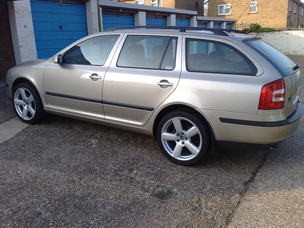

I had rubbing issues with 18x8 width at the back with wider than standard tyres on on my old Octy estate, I am sure that that 8.5x8 will rub more regardless of tyre size used. 18x8 with an ET of 42 already stick out from the bodywork, so I am sure the police would have something to say with another 1/2 inch or more sticking out.
The attached picture are 18x8 ET42 with 235 wide tyres on.
