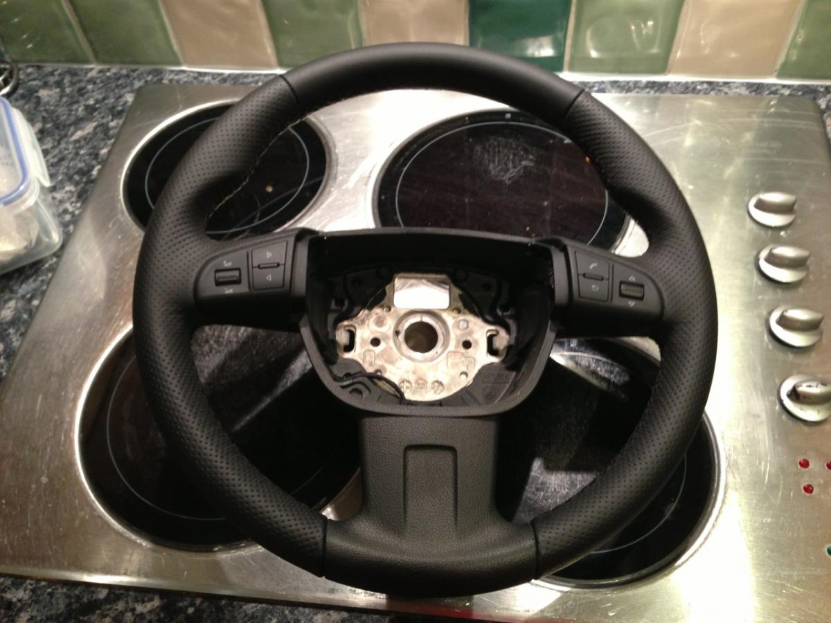

oooh, look what I've got!
My 3 spoke wheel arrived today from SkodaTeile for my 2011 Superb SE Plus Estate. It currently has a 4 spoke, but I find it a bit uncomfortable. This 3 Spoker is chunkier and should be more comfy without the bottom spokes that I find get in the way a bit..

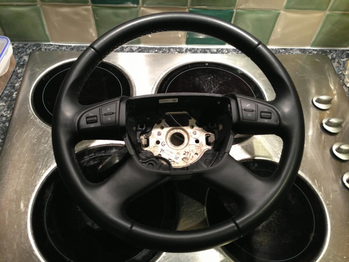

Did you have a 4 spoke MFSW or just a standard 4 spoke? Any pictures of the previous one? What are you going to do with the old one?
I had the 4 spoke MFSW before, so it was really just plug and play. I guess the old one is for sale.. I'll get some pics done and pop in in for sale.
Must be worth about £90 as it is? It has only done 15k miles..

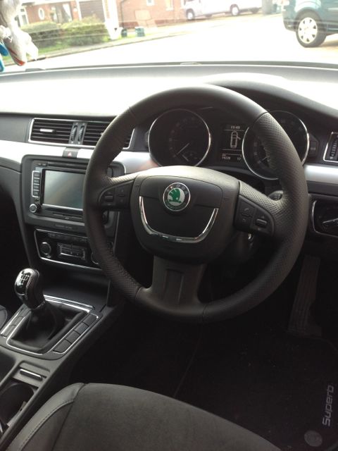

..and a pic of my old 4 spoker...

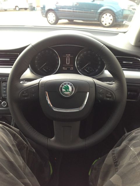

...and my new one fitted :-)
Looking good next to my retrofitted Columbus.
That's better. Well done.
Ta! I'm over the moon with it.. Now what else can I retrofit??
