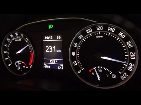

1. I want to have a big digital speed but in kilometers not in miles- like after changing for Australia. Tried to choose Germany as well but it's still in MPH. Haven't tried Rest of World settings as it's gone dark outside but I guess that it would be the same? Also tried to find any units conversions for that but all I have is simple time and petrol combustion settings... Is there any way to have it in kilometers?

I havent yet found a way to code the large MPH display in to KPH, I wanted this for a recent trip to Europe. No market change (Aus,ROW) affected this.

1.Thanks for fast answer.Yes- I thought that there must be a different setting to change for KPH, anyone knows which one?:) There must be the way... hope not too much intrusive - to not to lose warranty:)

I want to know about the big KPH too I spend most of my time in mainland Europe and it would be a lot handier! I think I heard about the forum in the past that Republic of Ireland cars have this screen and MPH (not 100% sure) can anyone try it and let me know.
