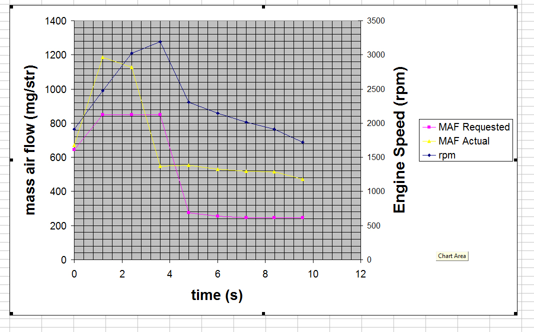

Ok first set of logs, did not manage to get it to the redline so may need to do it again. Was my first ever attempt :D.
Group A: '003 Group B: '001 Group C: '011 Engine speed MAF (specified) MAF (actual) EGR duty cycle Engine speed Injected quantity Spec. Inj. duration Coolant temp Engine speed Spec. intake press. Actual intake press. D.cycle MAP TIME 790-870 230-310 210-350 40-75% TIME 790-870 3.0-9.0 3-8 °Ck. 80-110°C TIME 2850-3150 2200-2400 2100-2600 35-80% Marker STAMP /min mg/str mg/str % STAMP /min mg/str CF °C STAMP /min % 0 882 265 259.7 69.3 0.42 882 5.2 5.6 83.7 0.82 882 1056 996 21.5 1.22 882 265 264.6 69.7 1.62 882 5.2 5.6 83.7 2.02 882 1056 996 21.5 2.42 882 265 249.9 70.5 2.82 882 5.2 5.6 83.7 3.22 882 1056 996 21.5 3.62 882 265 259.7 71.7 4.02 882 5.2 5.6 83.7 4.42 882 1056 996 21.5 4.82 882 265 259.7 71.3 5.22 882 5.2 5.6 83.7 5.62 882 1056 984 21.5 123.93 1911 645 671.3 51 124.33 2016 48 15.3 83.7 123.52 1827 1500 1488 47.4 125.13 2478 850 1185.8 4.8 125.53 2688 65.9 26 83.7 124.73 2205 2472 2292 66.1 126.33 3024 850 1127 4.8 126.73 3213 63.4 27 83.7 125.93 2835 2508 2520 64.5 127.53 3192 850 548.8 4.8 127.93 2436 0 -0.5 83.7 127.13 3213 1104 1896 63.4 128.73 2310 275 553.7 4.8 129.15 2247 0 -0.5 83.7 128.31 2331 1008 1308 36.7 129.93 2142 255 529.2 4.8 130.33 2079 0 -0.5 83.7 129.53 2205 1008 1236 35.5 131.13 2016 245 519.4 4.8 131.53 1995 0 -0.5 83.7 130.73 2037 996 1212 32.7 132.31 1911 245 514.5 4.8 132.71 1869 0 -0.5 83.7 131.93 1974 996 1200 31.5 133.51 1722 245 470.4 4.8 133.91 1701 0 -0.5 83.7 133.11 1806 996 1188 29.9 152.73 2352 850 1122.1 4.8 151.91 1974 33.8 11.2 83.7 152.31 2079 2364 1716 33.9 153.96 2940 850 1136.8 4.8 153.14 2604 65.9 25.5 84.6 153.54 2772 2508 2508 63.8 155.17 3486 850 1053.5 4.8 154.37 3129 64.8 27 84.6 154.77 3318 2520 2484 64.9 156.39 3717 850 744.8 4.8 155.57 3633 60.7 27 84.6 155.97 3780 2520 2460 64.1 157.59 2730 710 588 4.8 156.79 2982 0 -1 84.6 157.19 2772 1020 1488 38.6 183.01 882 265 254.8 70.9 183.41 882 5.5 6.1 85.5 182.61 882 1056 996 21.5 184.21 882 265 269.5 69.3 184.61 882 5.2 5.6 85.5 183.81 882 1056 996 21.5
Only manged to get it to 3700 rmp and already i can see the maf readings look fudged. :(. Neadle was bang on 90c for 10 mins but would not get hotter than 85c acording to the log. It certainly did not fell like it wanted to rev to the redline in 3rd :(. Any help with this much apprecated.

I think you need to log more data up to wide open throttle (WOT). Your current data is shown on the attached graph, which I sampled from the best block of data where you managed to get to 3192 rpm.
In general the actual MAF exceeds the requested MAF, which I think means your MAF sensor is ok.
