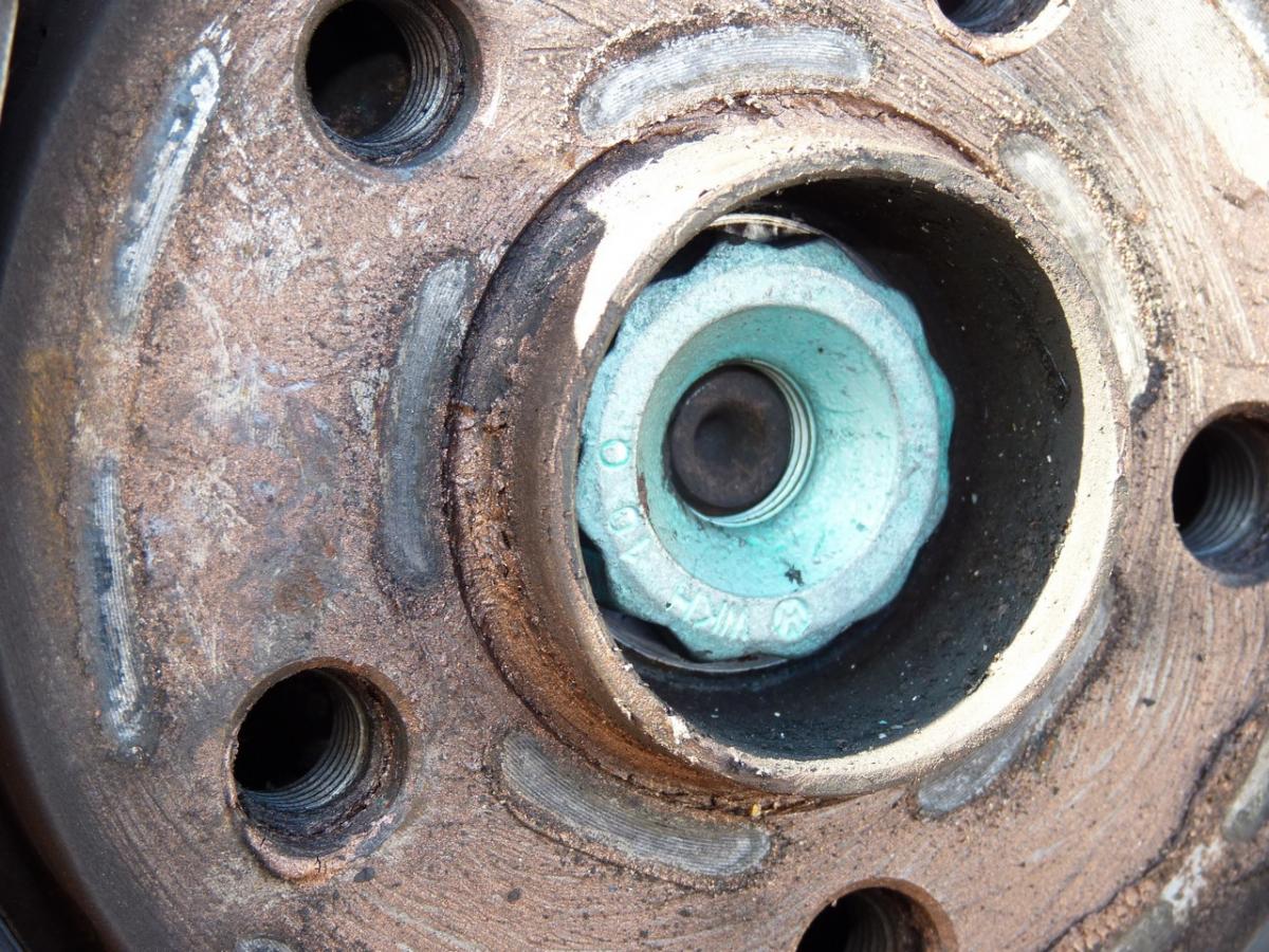

On the way home today I noticed a faint intermittent squeal from the offside, the garage was closed by then for the weekend. So when I got home removed the wheel trims I could see that the hub nuts on both sides are not fully home showing a few threads on each side and not a few shaft threads as normal, the odd thing is they are not loose and I could not tighten them any further using a long breaker bar.
This obviously not safe but for the life of me I cannot think what has happened. There is an excellent photo in a post showing the latest nut done up how it should be http://www.briskoda....ub-nut-removal/

That's normal and the front hub nut torque is very low, over tightening them will break the nut. It's something like 50nm and 45 degrees.

Please see my modified original post as I have added a photo of the passenger side nut and hub on original CV shaft. This is the one that scares me, there is about 50% of the nut threads not used!!! If anyone has the later hub nut on their Fabia I would be so grateful if they could have a look to see how theirs compares.
mogwye I checked the splash plate today it didn't seem to be touching but I gave it a good push away from the disc, odd thing is the main noise has gone but that side does seem to be have a bit rumble at low speed.
Checked Skoda workshop manual are correct Tech1e about the torque + quarter turn, don't worry I didn't jump up and down on the bar when checking it.
