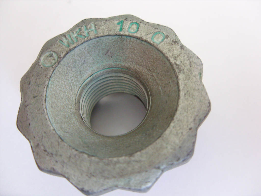

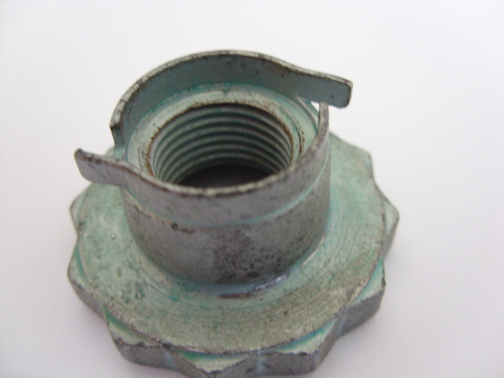

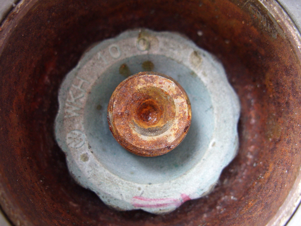

Need to remove part of front hub assembly to renew split outside CV gaiter.
My 36m/m (12 point) socket fits but is slack and twists around on nut, because of it's thick walls of socket !!
Also smaller size nut on rear wheels, with same shape. ( I think is a 32mm)
Skoda Mechanic uses - - - -
BLUE POINT LTS 4357 THIN WALLED DEEP SOCKET SET (3)
This set contains 30 - 32 - 36mm sockets.
The 36mm socket ref is LTS 4367
Edited by giandougl
Hmm - my manual doesn't say what size it is, but i think it could be a 34mm, 32mm is for the oil filter top from memory.
What I can tell you is the official tightening torque is 50Nm + 45 degrees :thumbup:
34m/m won't go anywhere near it, 36m/m fits but slips around under pressure.
Have ordered a 3/4" drive 35m/m socket from E.Bay with adapter to bring it back to 1/2" drive.
The 36m/m bi-hexagon socket I have, slips around as flutes are not deep enough to sit fully into nut flutes.

we use a 36mm at work, not perfect fit but gets them off. then we just replace with a new nut :)

Wheel hub nut is a M16 x 1.5m/m (thread pitch.) 36mm x12points
Seen SKODA parts fellow, who says their mechanics use a 'BLUE POINT' ( LTS 4357 ) Thin Walled impact socket set of (3).
The actual 36mm socket number was LTS 4367 coded.
I have in the past removed rear hub metal protective cap to reveal a smaller 32mm hub nut with same format/shape as front hub nut.
Believe it or not, mobile Snap-on fella says out-of -stock as recently ran a promotion on LTS 4357, and no idea/when will be back in stock.????
Receiving 'LASER 4146' Thin walled sockets from E.Bay soon, looks a dead copy of 'Blue Point' socket set.
Just tried the 36mm socket from the (Laser 4146) set, fits perfect, at last able to do job myself.
