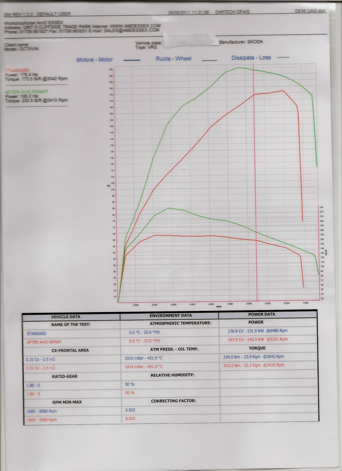

Assuming the dyno is consistent , and the drivetrain losses are measured accurately, the power (on AMD's dyno) was 176.5 @6488rpm. After map it made 192.2 @5351 rpm. Not a huge gain but peaks slightly lower down in the rev range which suits me fine.
Biggest surprise (for me anyway) was the increase in torque from 173 lb/ft @ 3042rpm to 232.5 lb/ft @ 3410rpm.
Now, I know peak torque is now 500 rpm higher in the rev range but the graph attatched shows that it is now making 200 lb/ft at 3000 rpm so torque is far higher at what was the standard car's original peak point.
At no point is the torque or power below standar at any point. Always a good thing of course.

Me too. A little dissapointing in that respect but it kind of leads me to believe the integrity of the company and gives me no reason to doubt any of the results. It's easy for the tuner to "massage" the figures to keep the punter happy but, because of the power figures, i'm quietly confident this has not been the case.
Also, i'm under no illusion that each and every dynomometer can give a different reading, hence the only way to compare cars is to use the same unit.
Of course, the dyno could have been under reading. Mind you, it could be the other way round............ :smirk:
