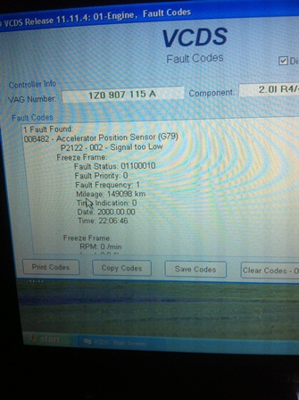

bought a mk2 vrs at the weekend having had numerous mk1's and the epc and engine management light is illuminated, car feels like its in limp mode it doesnt appear to boost at all, scanned the car with vagcom and its come up with the above fault code, i manage a breakers yard so i've replaced the pedal tonight but the fault code remains and everytime i erase it it reappears within a matter of seconds, vagcom reads
008482-accelerator position sensor G79
P2122-002 signal too low
freeze frame
fault status 01100010
fault priority 0
fault frequency 1
mileage 149098km
time indication 0
date 2000.00.00
time 22.06.46
any ideas greatly appreciated
