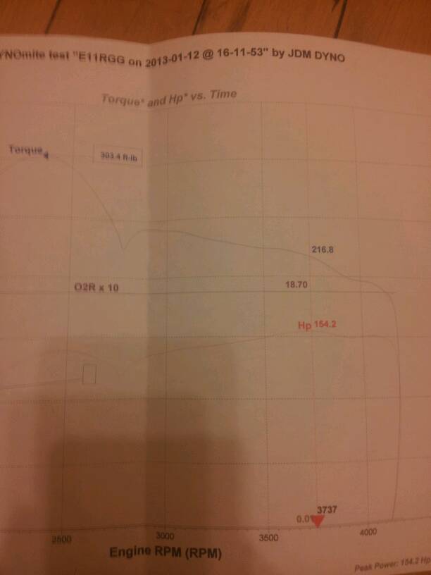

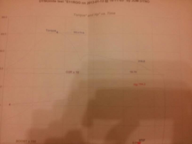

Hey guys, just got my car on a rolling road which showed 154bhp and 303 ft-lb of torque.. I recently got the map done and should be between 170-180.. The guy read the map and said that it is an acceptable map, but he noticed my MAF sensor was aftermarket, made by someone called lucas? I think it was lucas anyways, and he said it should be bosch. What im wondering is that if i fit a bosch MAF sensor do you think that it will sort the problem? Also, it was smoking ALOT and he said that was down to the MAF too.. True?

Lol Hello mate, you had thick Black smoke which is over fueling, maf sensor readings are interpreted and used in tables in the map thus if its caked up or not the correct type it will not run right.

Im.gonna get a new maf tomorrow, reckona bad maf can cause a 20bhp loss though?
If its under reading then yes. Theirs a smoke map that limits fuel dependant on MAF reading.
