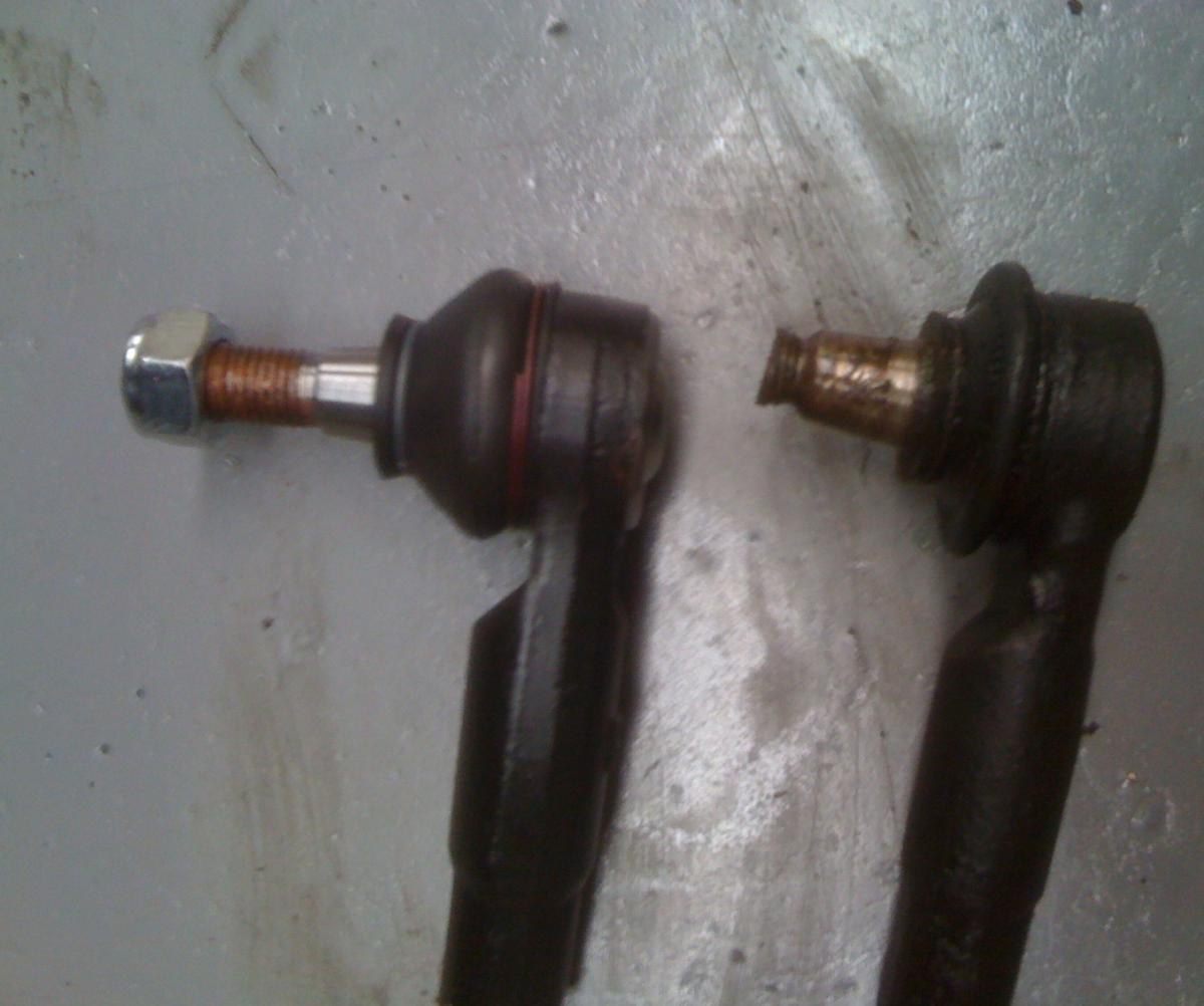

sorry for intrusion....can anyone help me with the 3 socket sizes to adjusting the tie rod? I cant remember correctly.Thanks!
Uploaded with ImageShack.us
It depends on the manufacturer but the track rod should be 13mm and the track rod end should be 18mm IIRC. Cant remember the lock nut
