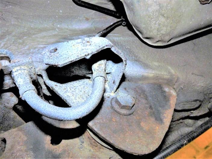

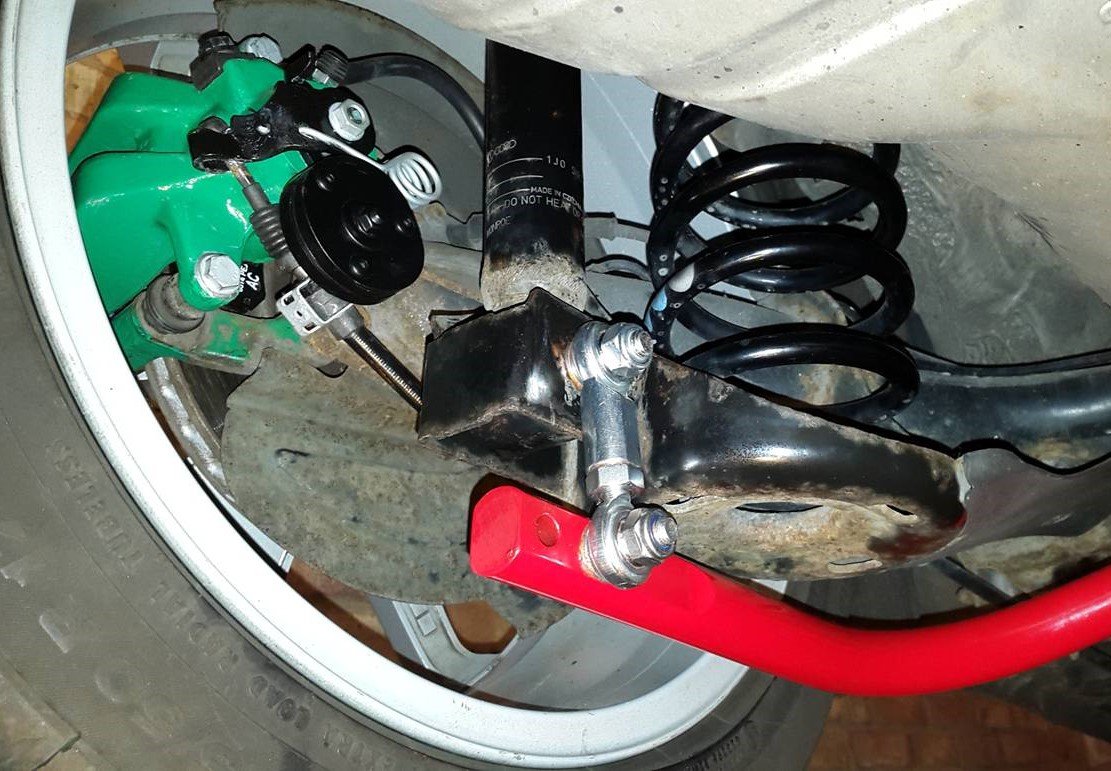

  4. I had a similar problem, bought 2 new rear calipers + b/pads, offside bled ok working fine, when I came to do the n/s (using pressure bleeding from the master cylinder) nothing, no fluid came out. Garage thought the ABS block had packed up or had a bad airlock. I bled the ABS using VAG-COM process still nothing. My final attempt was to replace all of the nearside brake line with Cunifer + flexable hoses from the ABS to the wheel cyinder. Bled it SUCCESS !!!. I think this hose is the culprit, and as was said earlier had collapsed and was acting as a one way valve. When I took it off bits of the inner wall came out :- The offside one does not seem to have such a severe bend, but I do plan to replace it as well. Also I would suggest fitting return springs to the hand brake mechanism (see below)

  6. I had a similar problem, bought 2 new rear calipers + b/pads, offside bled ok working fine, when I came to do the n/s (using pressure bleeding from the master cylinder) nothing, no fluid came out. Garage thought the ABS block had packed up or had a bad airlock. I bled the ABS using VAG-COM process still nothing. My final attempt was to replace all of the nearside brake line with Cunifer + flexable hoses from the ABS to the wheel cyinder. Bled it SUCCESS !!!. I think this hose is the culprit, and as was said earlier had collapsed and was acting as a one way valve. When I took it off bits of the inner wall came out :- The offside one does not seem to have such a severe bend, but I do plan to replace it as well. Also I would suggest fitting return springs to the hand brake mechanism (see below)
