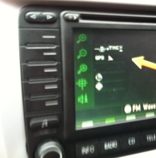

hi freedom pressed the map button and came across this page, not very clear oops.
my gps shows the map around were i live but the triangle that should show were i am is located about a mile away so if i put a destination in the gps follows the route from the wrong place. could this be due to the aerial. dawn
Sorry. I thought you had a Columbus...
And I'm not familiar with your head unit to be able to offer much advice based upon that picture.
Try what has been suggested with the aerial connection on the rear of the head unit first.
