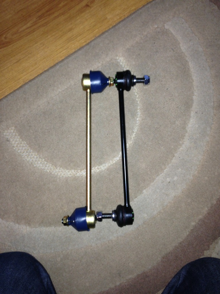

Ill take a pic and post it :)
There u go pal! Gold ones are fk black a mk1 mondeo ones :)
Mondeos are slightly shorter by about 4mm :)
sound cheers matey!

Mk1 mondeo i just fitted mine yesterday and im as low as it can go no issues
