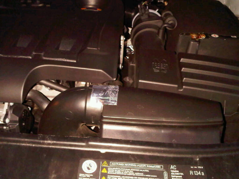

Any chance of a picture Jake.
bill

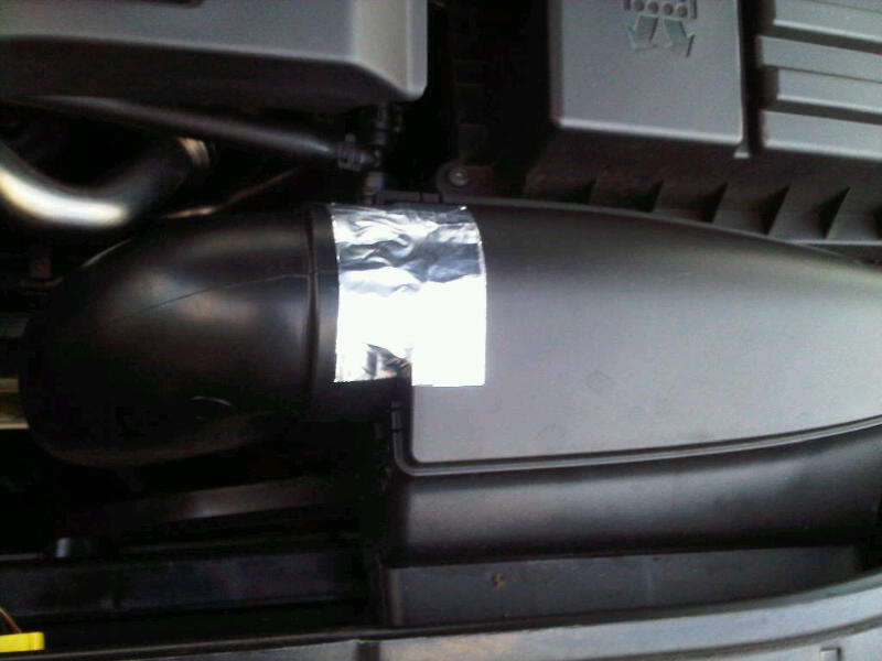

Here you go: taken this morning before my (noise free) drive to work...
I'm expecting the tape to rip straight down the middle from top to bottom, where the air intake housing (on the right) is supposed to join the elbow connector(on the left). There is a lot of play between the two at the moment.

Will try it and see. Could you maybe post a pic showing a bit more of the engine bay, so this numpty here can put the tape in exactly the right place :doh:
Will take more pics tomorrow. I think something like gorilla tape or cloth tape will be better than my multi-layers of alu insulation tape, as they will be more resistant to ripping. I've just ordered some cloth tape which I will stick on top of the bed of alu tape I have already put down.
Day 5: still no noise, and tape still intact...
A pic especially for yearofthegoat.
Hopefully clearer where I've put the tape in relation to the engine and battery.

Hey it would be so nice if you could post a pic of how it looks in the end with the super stable tape system you build up.
Looking forward to do the same on mine!
Thank you!
Sent from my Nexus 4 using Tapatalk 2
It looks the same as in the above pics, but now mostly black where I've added the black tape directly over the alu tape. None of the cloth tape is touching the plastic of the air filter assemblies - only the first layers of alu tape are, and that is very sticky stuff indeed. Used it to hang some pretty hefty multi layer insulation on my garage door. But you can tear it easily with your hands - hence I've now put cloth tape on top.
That's perfect- many thanks.

what inlet pipe is that and where is the pipe please.,can we see a photo mine is driving me up the wall.
bill
In my pics above, look at where the metal tape is, and the two bits of the air intake that it is holding together: an elbow joint pipe on the left and a rectangular box on the right. The problem is that they don't fit together very well, and so it is the elbow pipe on the left that they are going to replace to hopefully stop the rattling.
If yours has the same problem then you should notice a lot of play between the two adjoining pieces. This is definitely where my noise is coming from.
I quickly put a couple of layers of carpet tape back on when I got home today. Peace and quiet again...
