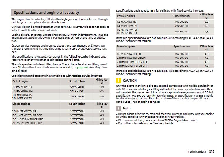

Not suitable as Yeti's should have VW504 or 507 spec, depending on servicing regime.

There's no reason why you can't use this oil for your particular Yeti, provided you're on fixed servicing, as it meets VW 502.00 homologation.
Wrong.
Sorry, but page 246 of my handbook tells me that for a 1.2 litre engine on a fixed regime the spec is VW 502 with a content of 3.6 litres. And the oil I quoted is VW 502
Yes, for the fixed service you can use the non-Longlife oil, 502 00.
