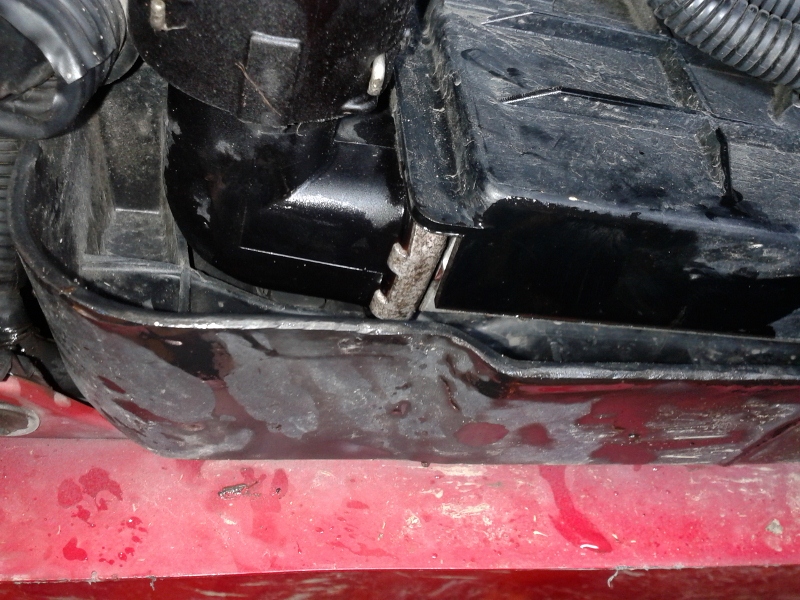

Hi I have I fabia vrs and have a leaking radiator I think, been loosing coolant since I bought the car but only small amounts needs topping up every 2/3 weeks but have not been able to trace the leak until I carried out an oil change last week and found small amount of coolant around the bottom left corner of the radiator see pic if I have managed to attach it ok. Looks like it is leaking from the joint between the alloy rad and the plastic ends but not 100% sure what do people think?
If it is the rad I will attempt to change it my self and have found 2 listed on Eurocarparts an EIS one at £51 or a valeo at £103. Has anybody had any experience with the EIS radiator or is it worth spending the extra on the valeo?

check the sensor just above there that's a normal point it leaks as well.

This is a common fault across the VAG range, they tend to fail from around 5 years old onwards, the bottom corners corrode and they start to weep coolant once the system is up to temperature and therefore pressurised.
Don’t forget to get some G12 coolant as well, in fact it’s an ideal time to do a coolant change, considering most of it will have been dropped out during the rad change.
