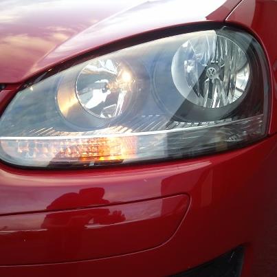

From then I had the front & rear bumpers colour coded With gloss black inserts & sideskirts also colour coded.

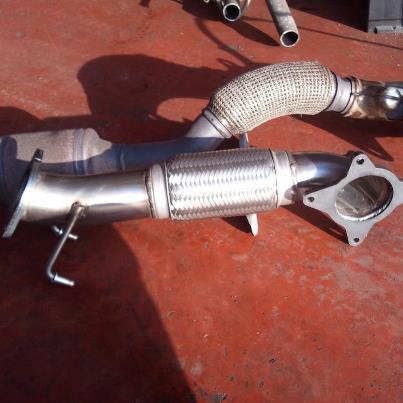

Then the Neuspeed intake was fitted, followed by 3" downpipe & decat system.

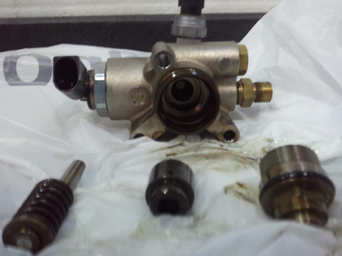

The last thing required to make this ready for the Stage 3 Map was the HPFP upgrade. I then stripped the HPFP & fitted autotech internals.

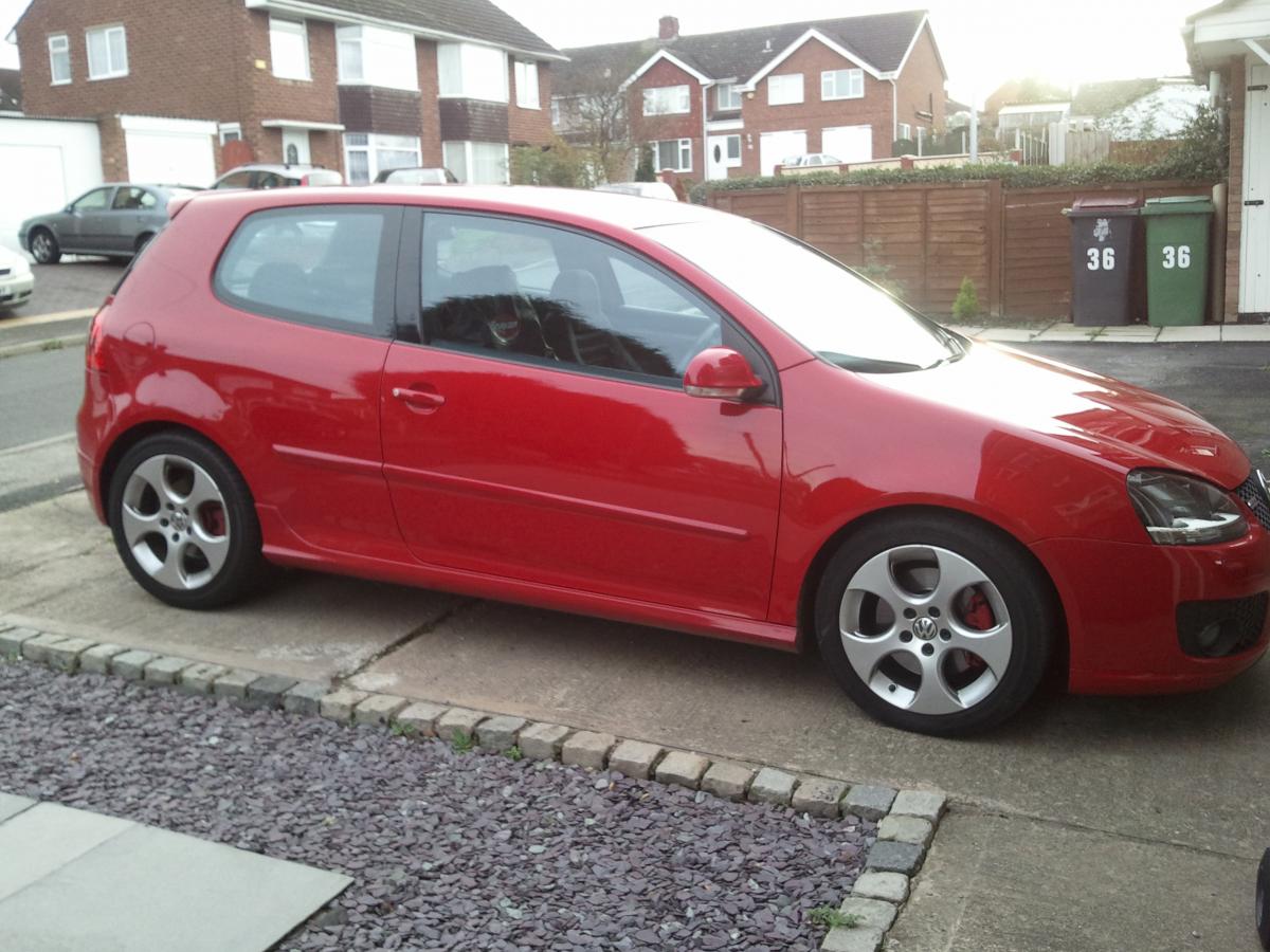

I then found a set of 18" Monza wheels as the 17's looked too small.

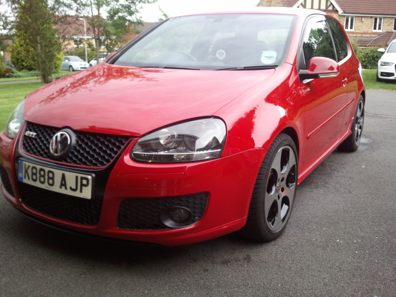

Here are some photo's of the old girl.Thanks for lookingAnt
Still love this :D and bloody fast too!
