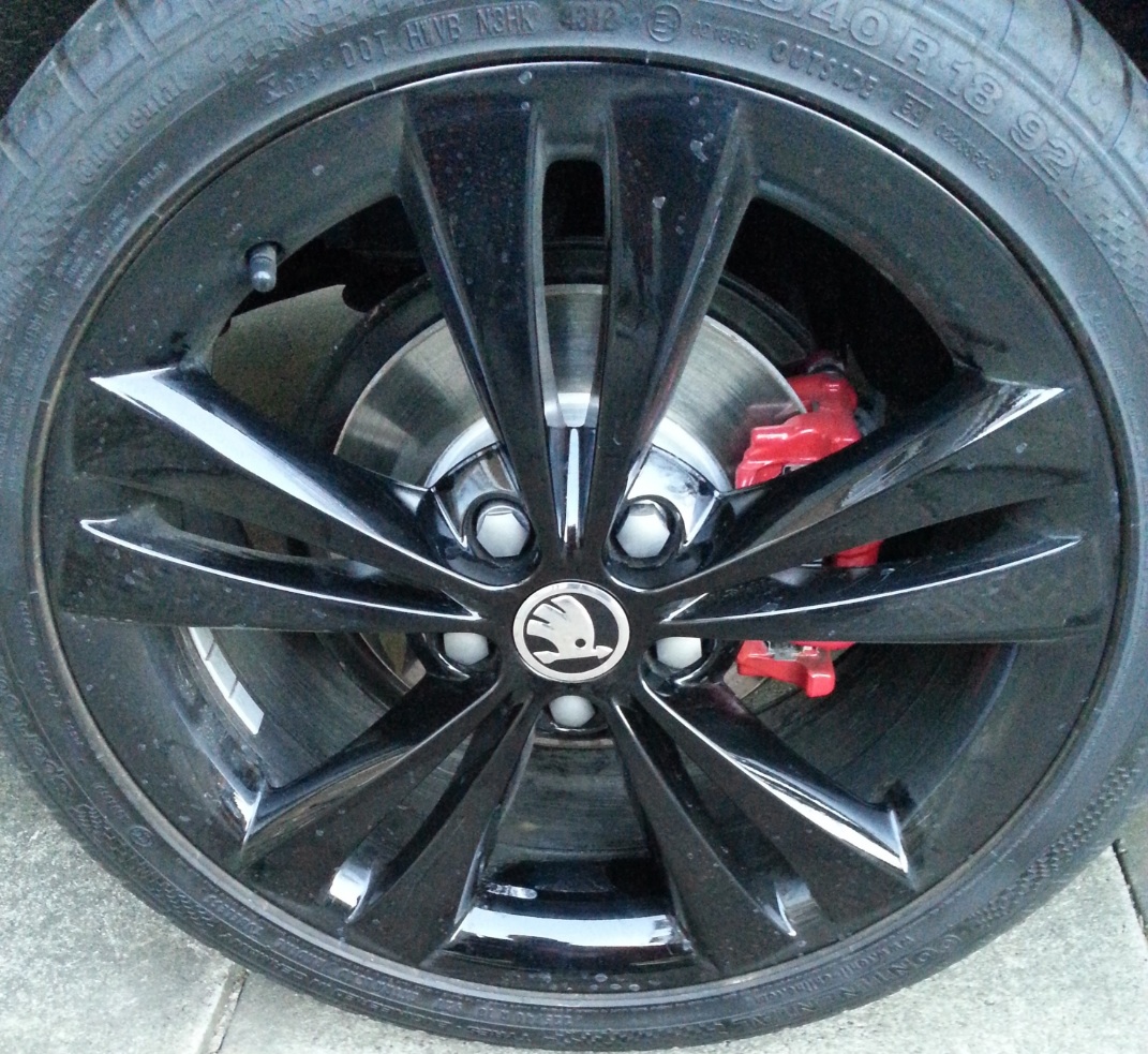

Here's my new centre caps....sorry about the quality of the pic and the state of the wheels!
