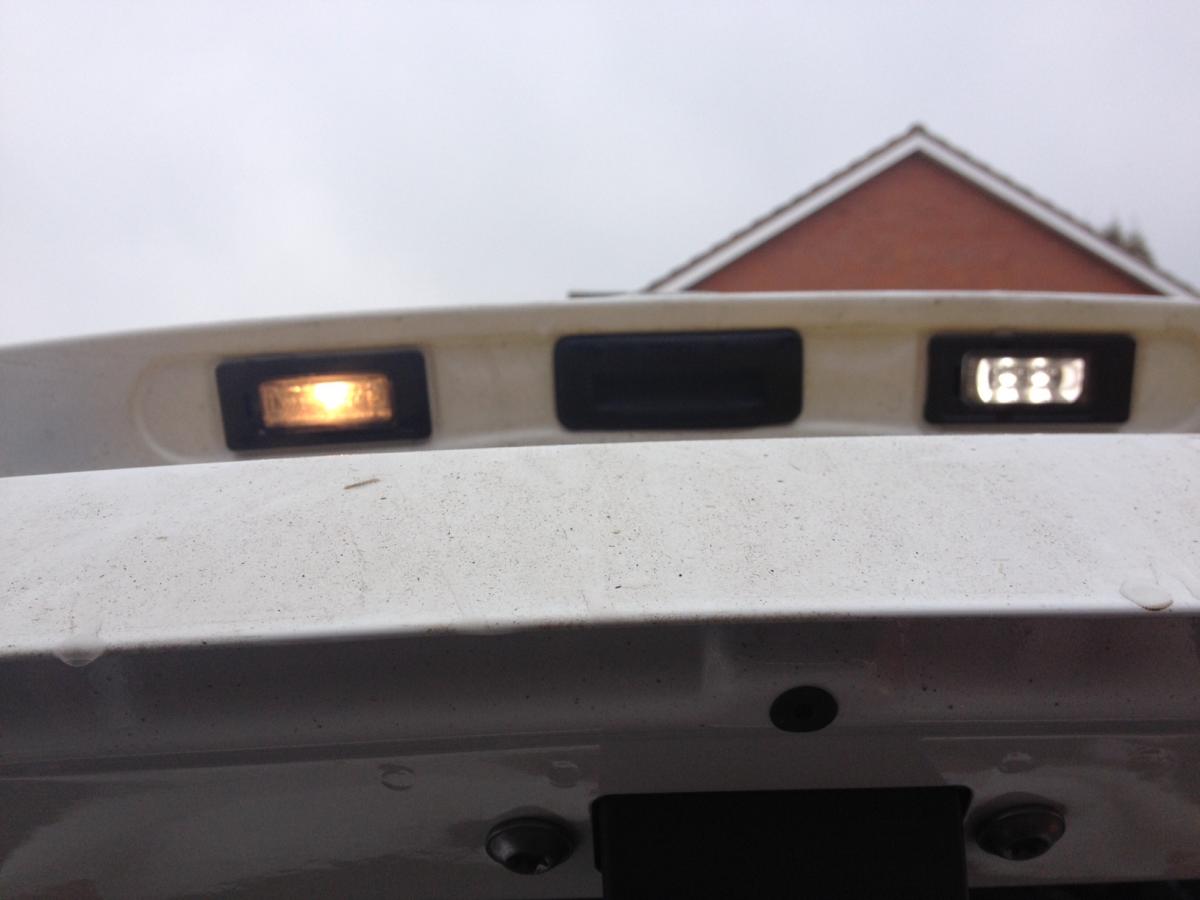

Fabia LED number plate lights. OE
Just fitted these to my new Monte.....post-26506-0-41004800-1364124522_thumb.jpg
Don't bring on the bulb monitor and plug and play.
Its all about the little touches, the ones I used deceided to throw on the check light after several weeks, even though they work fine, so when I can be bothered I'll get around to changing them for something different.
These are off the current Audi A4 and fit as a direcr replacement light unit and are sealed.
You just then make up a 2" patch lead with the 2 Audi ends on them so they are plug and play, fitted in seconds.
