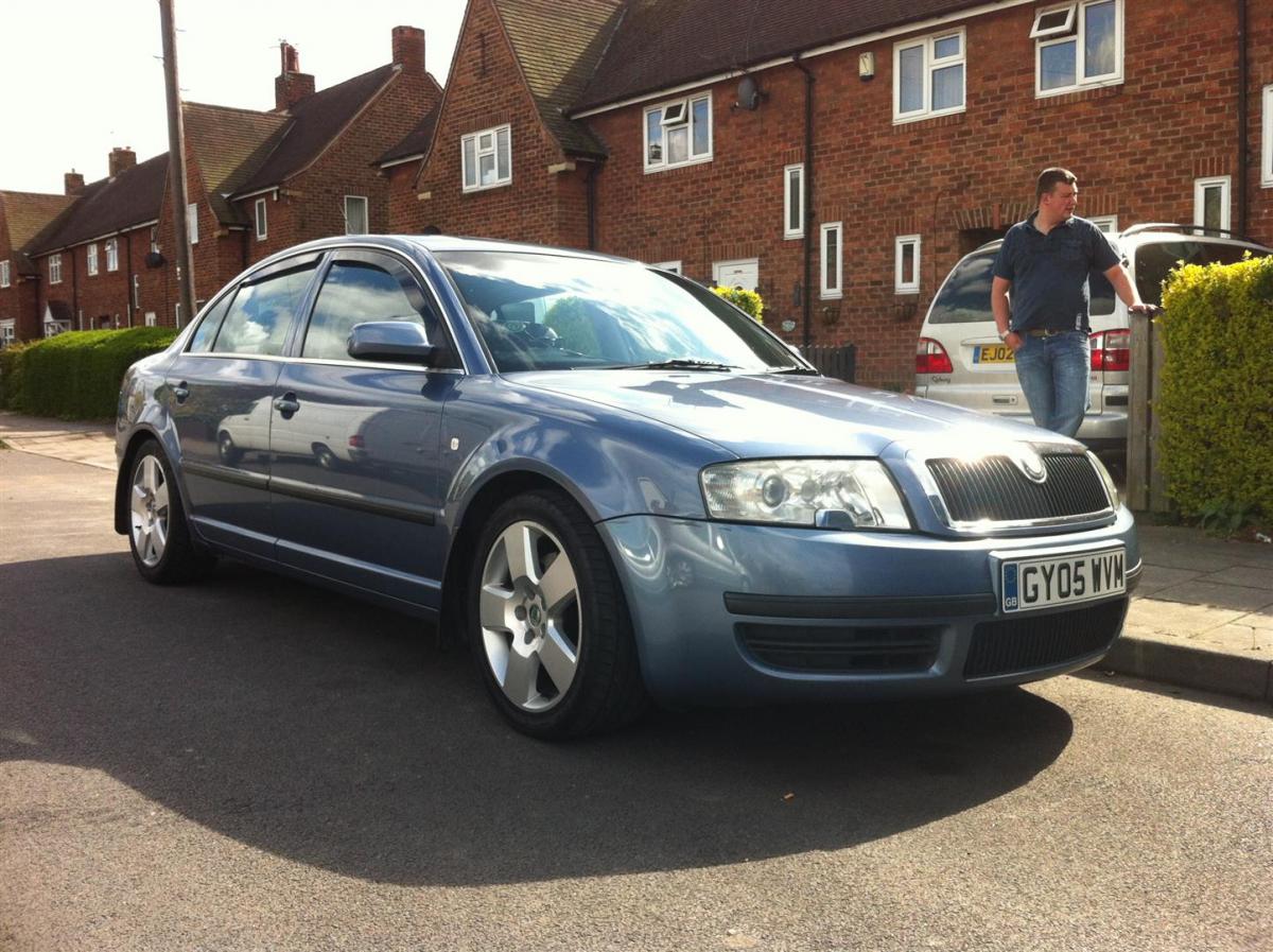

dieselV6 is there any chance of a pic of your car, just interested in how it sits?

My car is in the garage now, not enough space to take a side-on picture. Due to hols we are using Roomster only for the moment, next time the Superb is out I might take a picture, but it could be a quite a few days away.

Photos on a slightly uphill driveway, front Sport V6 TDI Auto springs, rear factory HD suspension springs, B6 shocks all round, 16in alloys with 205/55/16 tyres at 2.9bar. Now that I look at it, rears have sagged somewhat over the last 7 years, but the rear is still higher than the front.

Thank you for the pictures and your input in all this. After a week or so of thinking should i just change my car i have come to the conclusion that i do not think i could buy anything that would give me the space and power of the superb other than buying another, as the new shape does not come with the v6 engine i think i am just better off spending a few quid on mine and running it for the next few years. I know there are the people of the opinion the v6 is no better than the 1.9 but i have had cars with the pd engine (still got one sitting on the drive needing 2 injectors) and even with a remap the performance is nothing like what you get from the v6.

From the picture, rear ride height would be a bit low for my needs, half term trip soon with full boot and a towbar box carrier :) But for standard loads it looks OK.
