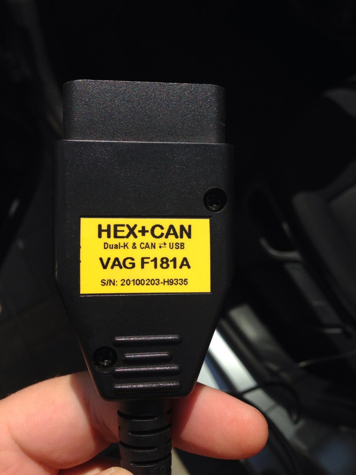

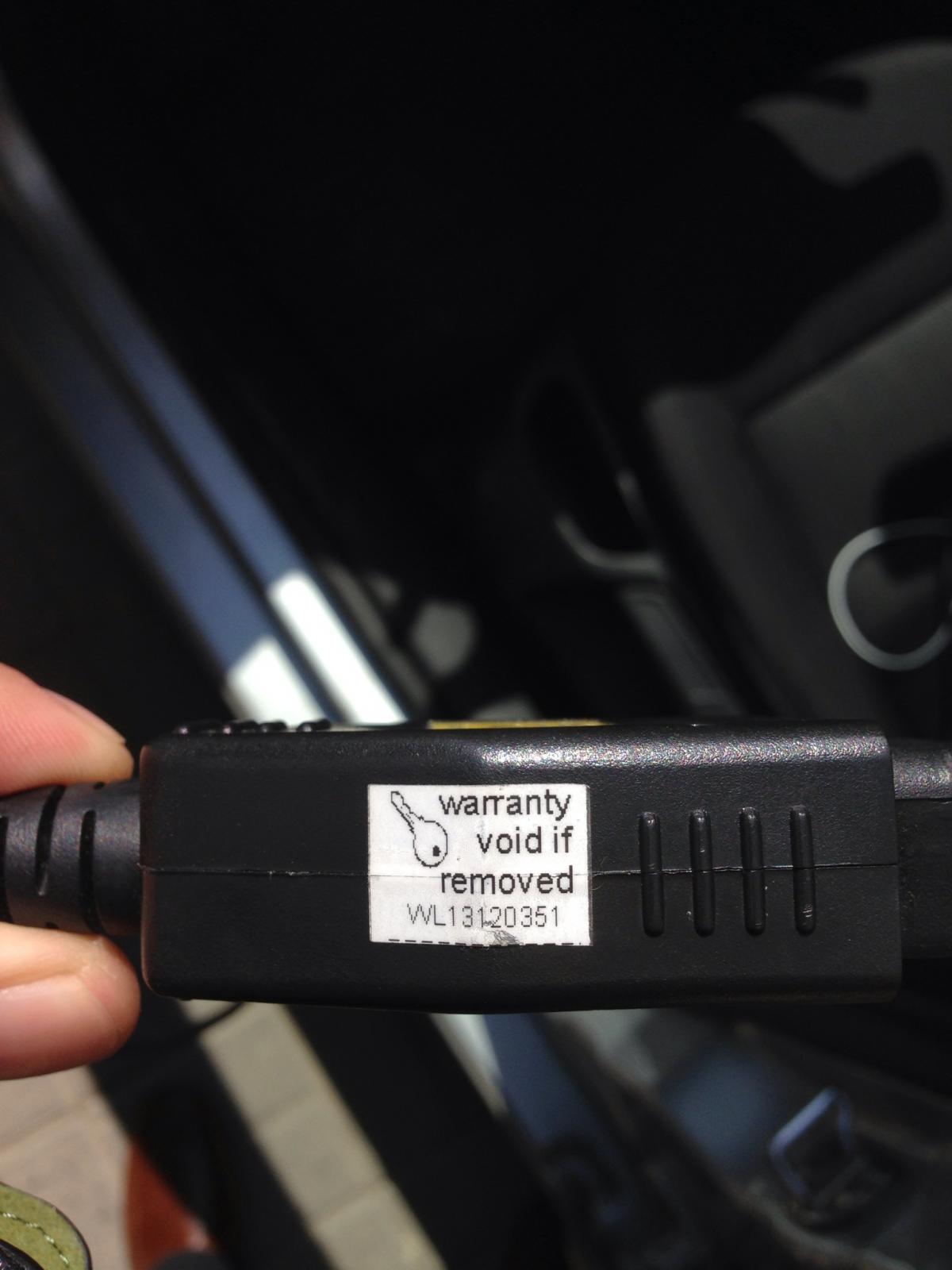

here a some pics of the obd connector.
how can i check that the cable is genuine or not?
It's a fake. The labels on a genuine one don't look like that and there is no mention of Ross-Tech.
Contact Ross Tech (with the serial number) and ask them.
They probably won't offer support unless you buy a package ($99 I believe) but I'm fairly sure they will confirm its authenticity.
