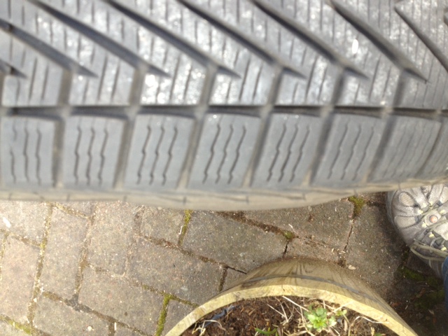

They said "You still have your winter tyres on and one is deformed" - Ok, 225/40/18 Vredestine WintracXtreme's are fitted to genuine rims. - so i took them off when i got it home and changed to summer...

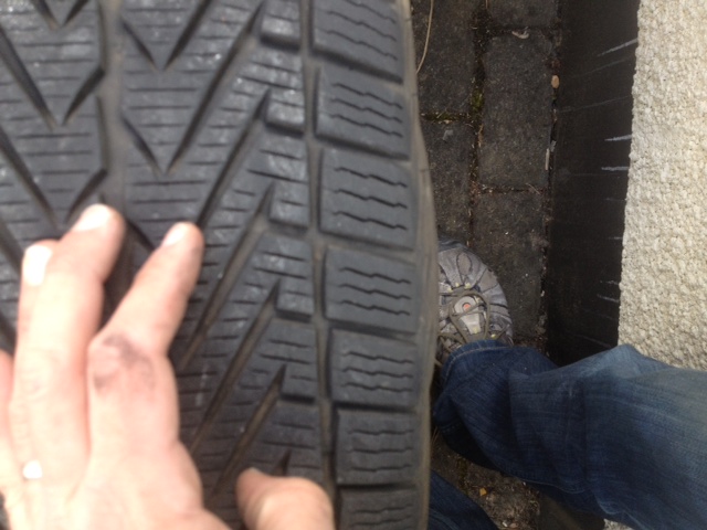

This is what i found in one of the front tyres. - Two rather large Blobs in the inner side-wall...
Erm, so really, should it have passed....?!

I would be sending these photos direct to Vredestein. They are now aiming to be branded a "premium" tyre and I would hope that they may compensate you in some way. I ran the same tyres this winter and they have been 100%.
Give it a go............
Should it have passed NO
It looks like delamination of sidewall, most likely potholed or kerbed, garage should not have allowed it on the road. Sidewall could have blown out at any time.

Just had a quick look in the Tester's Manual - Where a bulge is due to internal structural failure, it should be a fail, not an advisory. Your tester should not have passed this. (IMHO)
Yep, that's a dangerous fail. I've just replaced one of my summer tyres before they go back on as one looked like that.

Yeah, i didn't think it should have passed either!
And strangely, no word of it on any paper work... Might email Vred' - noting to loose really..!

Makes no difference the tyre was dangerous and the vehicle should not have passed the test or been allowed to leave the garage.

Mot testers are in the most part human , they can make mistakes and miss things

Not my car... drove it the day before test and didn't feel right so asked to check out the vibration from front end. Blebs were on the inside of the tyre.
Al.
ps. It went back yesterday - the MOT tester who did it, "wasn't in" but the head tester said he would have failed it, or at very least given advisory - and a new SeatBelt receiver is on order under warranty.

Nothing wrong with the power , the front tyre looked like this
I've failed tyres for a lot less than that. The last owner of a car that I failed on two tyres and advised another had a bill for £700.
The aluminum wheel is also damaged. Hit a kerb?
well the car has to be tested as presented so whatevers on the vehicle at time of test is how the cars tested
tyres are one of the most important to look out for on a test really ,
