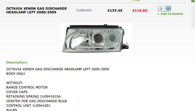

Hi all, I wanted to know if this headlamp fits a 1999 Octavia L&K (glass front)
http://www.skodapart...2000-2009-50258
OCTAVIA XENON GAS DISCHARGE HEADLAMP LEFT 2000-2009
BODY ONLY
Because where I live the only skoda dealer is quoting me around US$1,000 per headlamp, and on the web all I can find are the ones posted above which are post-facelift I believe. Basically what I don't know is if the mount points are the same – basically if I could have done a straight swap regardless of the accident.
Later I'll figure out how to get these from the UK down to Peru, but common decency will NOT let me spend $2,000 on my headlamps (glass smashed in a slight collision, the mount is fine)

Is yours a mk1 pre or post facelift?
In the UK when they did the facelift and changed from glass to plastic lights they changed the design of the lights, grill and bumper and you can't swap parts over.

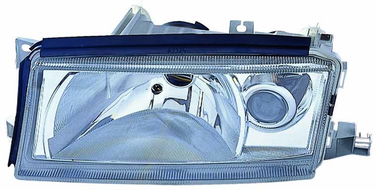

Mike, they may well be! Are they like the pic attached? (mine had clear glass but I'm not sure if all do/did)...And do you know if the mechanism for tilting the lights up/down is part of the headlamp, or part of the car itself?Those would be my only couple of questions...Cheers
I'll dig them out tomorrow and take some piccies. The headlamp levellers are part of the headlamp but the connections from the car wiring harness are different; pre-FL has a separate external connector on the harness and post-FL has the leveller connector internal to the headlamp unit - ie. no separate external connection.
