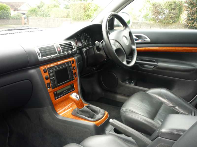

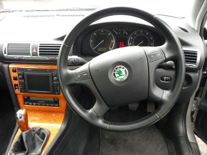

One thing that I am still deciding whether I like or not is the wood effect trim around the head unit, gearstick and down the doors:
I've searched some possible replacement kits on Google but I'd like to know how easy it is to replace from some experts, and whether anyone could recommend a good supplier?

dash area is simple, slightly more challanging will be the trims on the door but the use of a picture always make things look a bit easier.

As said previously, the dash trims just need a gentle pull. I have removed the same trims several times on my own. The cigarette pocket is attached with (if I remember correctly) 3-4 screws. To remove screws, you need to remove the trim around the radio and climatronic and the trim around gear lever. Then it will reveal the screws. Also you need to remove (just pull out) the cigarette pocket "pocket".
Rear trims are kinda same. Just pull off.
Door trims (if again I remember correctly) are actually welded to doors, but I don't mean metal welded :D. The trims have a plastic inserts on back of them. If they are installed in factory, they are melted so they wont fall of from door cards. To change these, you need to melt them again and just wiggle them out. Inserting new ones (even if you get them from junkyard) you can install them with double sided thin tape. I remember there was a thread about this, but don't know where.
If I remember, then I will take some pictures, when I take my door card off this weekend or next week.

on the topic of changing the dash trim colour. i changed mine as i had the pd100 classic trim which was just plain plastic so wrapped it in gloss black vinyl wrap i purchased off the Bay and once i wrapped it all i was impressed at the big improvement it made.. looked very similar to the trim from the edition 100 superbs. soon im gonna buy some silver vinyl wrap to retrim the dash again as i would like to try and replicate the silver trim you get in modern cars such as that in my dads 2009 highline passat. if it doesnt look good i will simply peel the wrap off and buy another colour :-) a simple and ratehr cost effective way of improving the appearance of the interior. :rock:
This is the gloss black interior trim in the edition 100 which is how mine looked once it was wrapped. :giggle:
