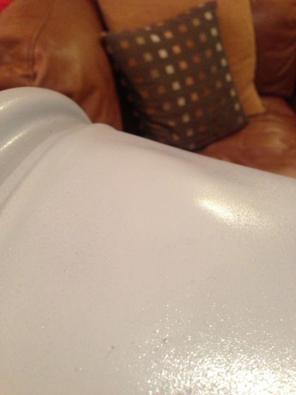

Hi looking at buying some wheels but need to check if this will be ok

Yeah dent on inner side but no sign on outer ?
Looks like a big old dent. I'd avoid that, if only because it'll make balancing a sod.
That would be really weak and dangerous, keep away

Looking at buying there genuine bbs ch 19" for 600 just been refurbished
Ok thanks for advice that's what I was thinking just what'd some advice guys
Have another set in mind so its ok just abit further to go :(
There could be stress cracks under that paint, alloy doesn't bend well

Ok thanks raf ill take your advice and leave well alone
