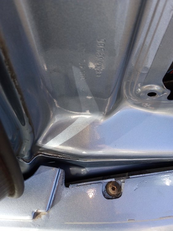

Had another go today and believe I might have solved the mystery. Took the O/S rear light cluster out and noticed a gap between the panels. I have filled with mastic and hope to find the boot dry when it rains. I have attached a pic so you can see what I found.
Is this left rear light?
