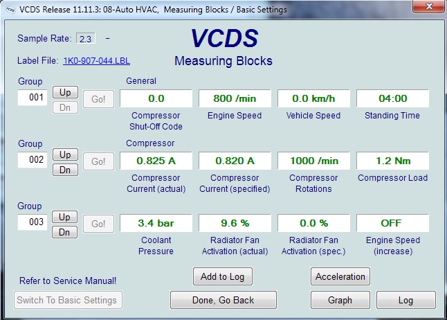

I've connected up VCDS and it looks like the compressor is turning..
If i press the ECON button then the load and rotations on the Compressor drop to 0 indicating it is turning and its not jammed but when you press it you can't hear any change in noise from the engine bay so I am not sure if that means the clutch is not working??

Looks like when under max load (i.e. when set to LO) the most i get is around 1.2Nm of Load and the Pressure is sitting at 3.4 bar which looks very low.

I've read that the AC radiator fan should always run when the AC is on. Using VCDS it does show that its requesting to to spin (slowly but still spin) but I have not seen the fans spinning at all (and thats also being reported by VCDS)
Does this mean I also need a replacement fan as well :( Will have to try and get the multi-meter out on the plug although annoyingly its at the bottom of the fan housing not the top.
