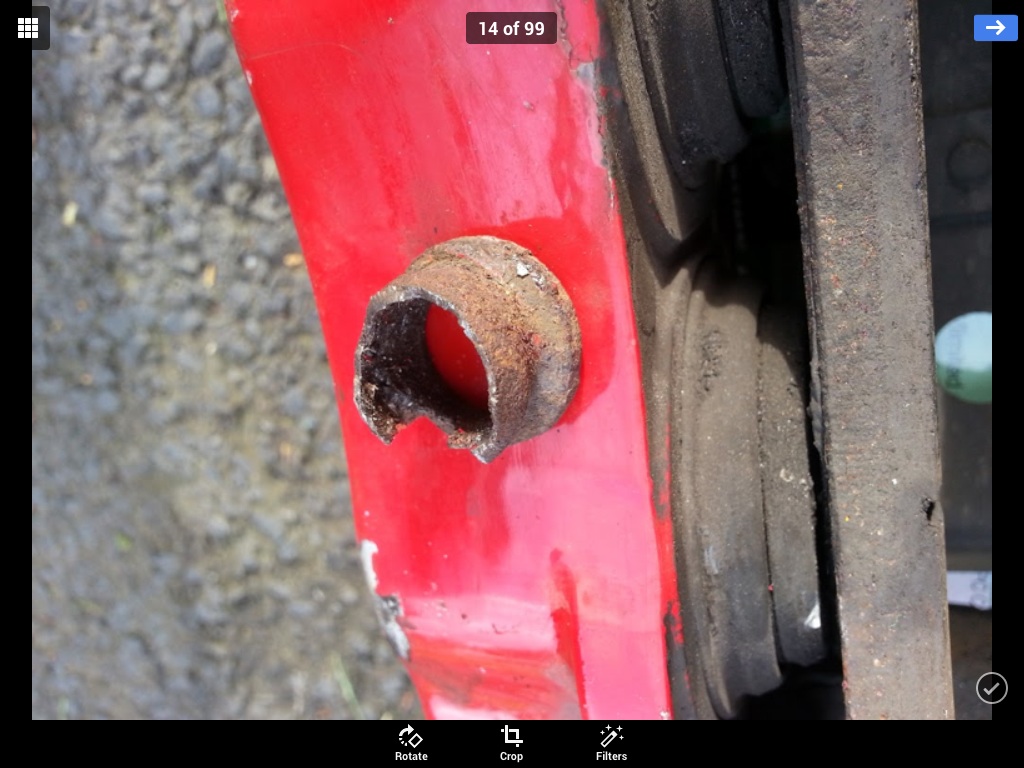

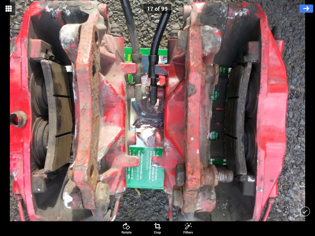

I bought these 4pot Brembos with 343mm Ap Racing discs off Fleebay last month but when installing them today I noticed that the collars on the first calliper adapter have snapped off! And the second one has a bent collar. Ive seen some cheap copy adapters on Fleebay but I don't know whether to trust them, let alone know if they fit. I haven't messaged him yet, I'm hoping that he will do a part refund as I really want the discs ;)
They look dodgy as ****!
I sure wouldnt use them. Send back and juat get the lcr kit wit proper brackets and 323mm disks.
They look pikey as hell
Wtf they look lethal, agree with billy send them back

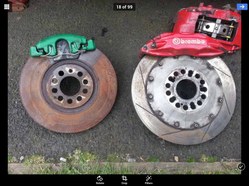

are the discs designed for the octy, as look like they have been redrilled from something else...not that well either

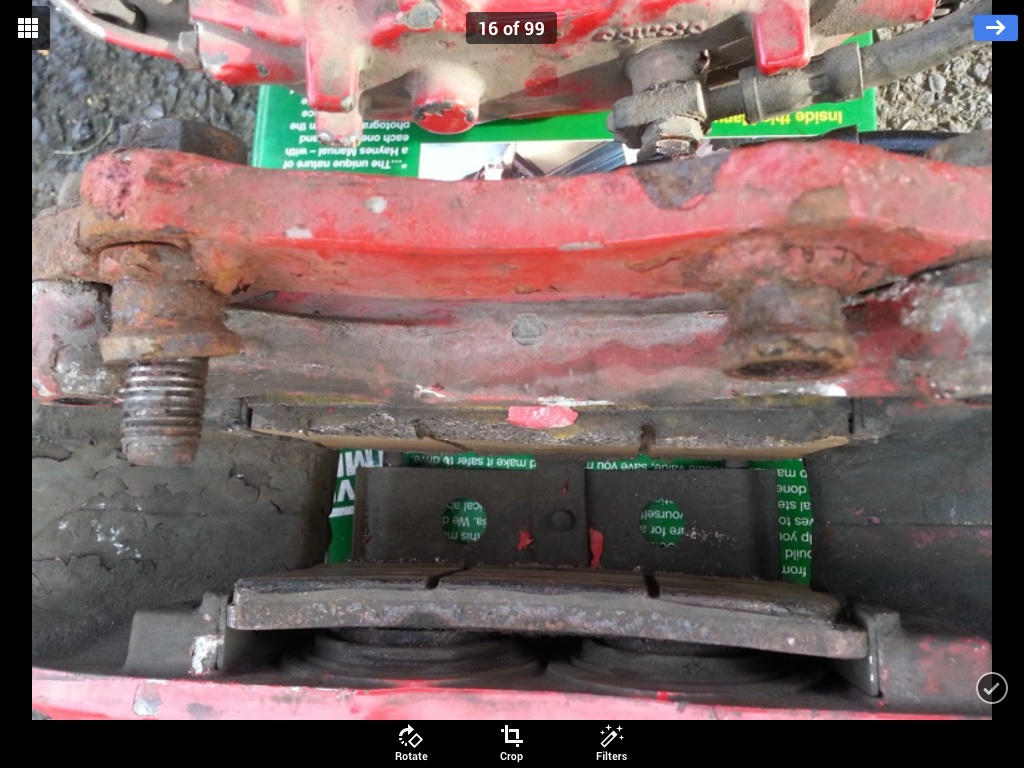

Its new collars/shims you need, the look of it.
A machine shop should be able to knock up some replacements without hassle.
They do need a bit of a refurb, but dust seals look good, which is a good sign

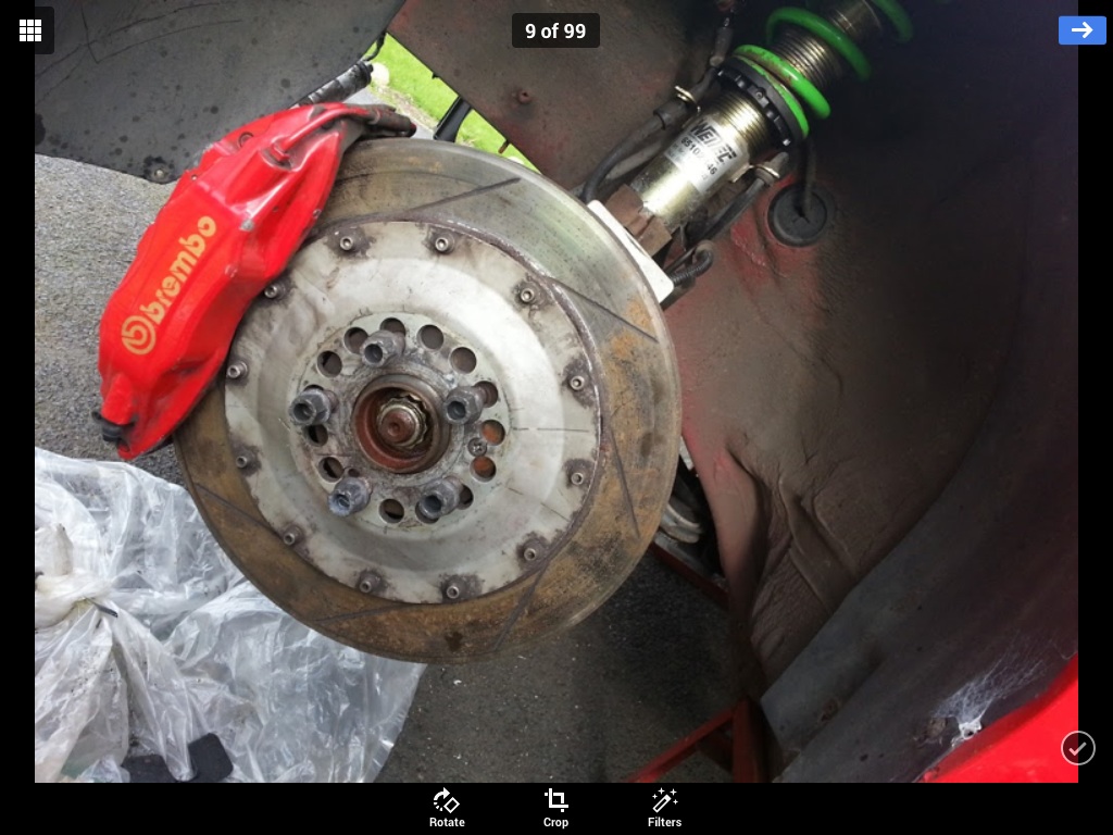

I'd be more worried by the bell. Have the extra holes been drilled to fit to 5x100 ?
eg red circled holes:
If so, Might be worth getting a new bell
The lugs are just a spacer, in theory you could just make sure the bracket is flat and make up the width of the lug with washers, it would do the same job.
But as said those bells look dodgy as you like.
yes either washers or a milled piece from a machine shop, as said have seen some kits made up with washers anyway. Thats not the bit that would concern me, its the redrilling and all of which are through existing holes. Not ideal at all imo. A new bell would be a good solution.
The rest can be sorted and refurbed as required. There is a fair bit of ally corrosion on those, so i would def sort that at this stage too.
Thanks for you're replies, it's seems apart from the adaptors a few are concerned about the discs. Well I test fitted them today and they must have been machined holes as the bolts line up perfectly with no play at all. So it's just the adaptors now! I've contacted the seller and we're working out a part refund to cover the cost of new adaptors and a new metal hose line aswel. What a nightmare! They was packaged up in news paper!!!! Yes NEWS PAPER!

I know yea, just to get a idea of how it looks as the other calliper has no collars/spacers
its the fact there isnt full meat around the new hole to enclose your bolts, ie part of the new hole has no surround. Under extreme conditions its not going to be as strong as a new hole in sold metal. Looks like a bit of a bodge imo, and bet ap dont sell em like that.
I would not want those brakes on my car. As mentioned, there is not enough meat around the wheel bolt holes. You won't like this, but take them off. Now. And get some new bells machined up.

The brackets could be saved with new (better) spacers but the bells are toast IMO
