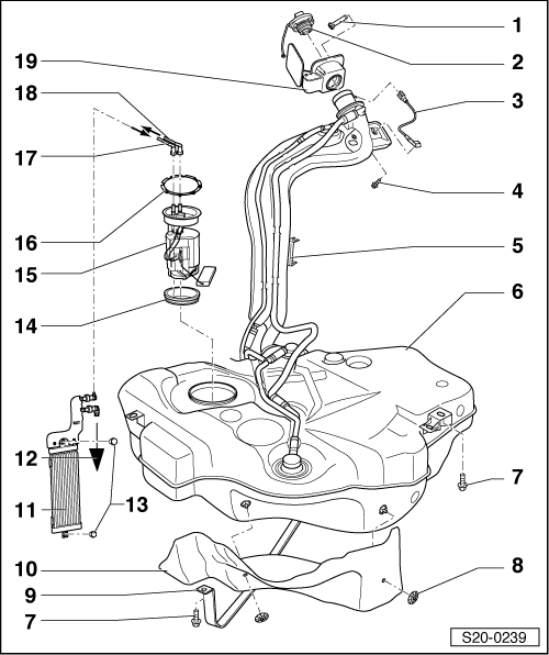

My car's fuel tank squeaks when em driving n also squeaks when I press the brake pedal. On red lights i can hear the squeaks because of fuel swinging in the tank when the car is stand still. Its very annoying and irritating. I have checked the fuel tank underneath by trying juddering with my hand and could hear the squeaks.... Any ideas what could be wrong...??? Does the tank is mounted on rubber sockets....???

Looking on Elsawin it doesn,t seem to show any rubber type mountings
If you're pretty sure it's then tank then could it be coming from the neck section?

Found and sorted the problem...
It was a heat shield of the fuel tank which was making that noise... It is attached via screw locks.. got them fastened well enough.... and now no more annoying sounds.
