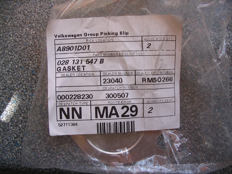

Anyone got a picture of the location where i have to replace the gasket for the 14mm one? Think i know where it it but need an actual picture so im 100%
Excellent link cheers bud :) i never realised the gasket was metal :/ think i could use other material to make one?

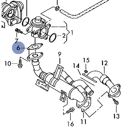

Some pictures from the time when I did mine. Position 11 on the diagram is where I put the gasket (you can see this in the engine picture). At 9mm (as supplied) the engine management light would come on occasionally if I drove in maximum economy mode (like a granny), but it would go off again when driven normally. I expanded it to 10.5mm which seemed the best compromise. The "official" Skoda fix which was later withdrawn due to high NOx emissions was 14mm, but this did not eradicate the stutter.

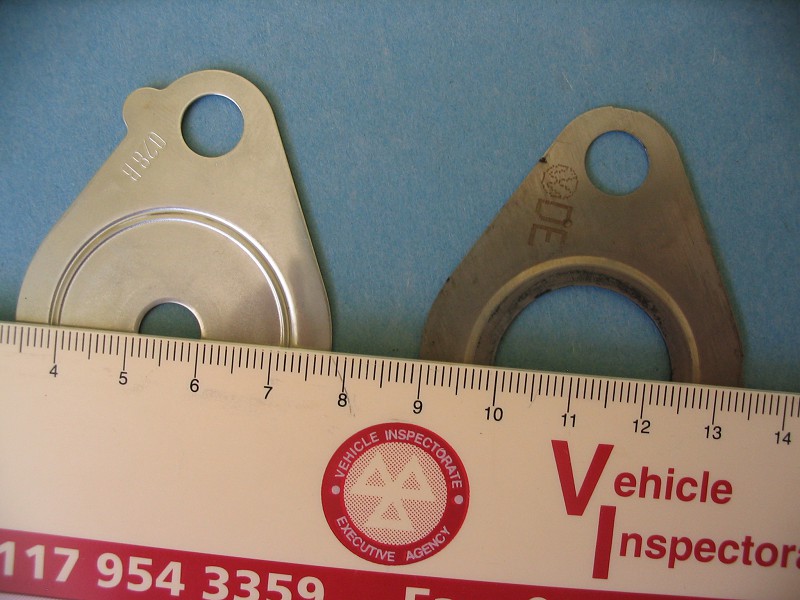

Hey guys, just made and fitted my own gasket and its fixed the hesitation issue :)
Bolts and gasket removed ( 6mm allen key )
Gasket material i used ( steam pipework gasket )
Old 24mm gasket and new gasket drawn up ( 10mm centre hole not drawn yet )
Gasket cut out compared to old one.
Fiddly job but worth it :)
