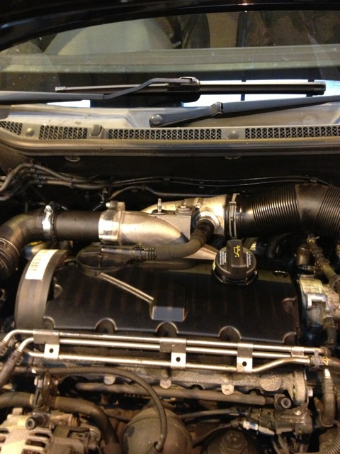

Fitted My EGR Delete Kit Tonight
Fitted my Allard EGR delete kit tonight, i removed the pipe and fitted the blanking plate to the manifold, i also put black heat shrink on the "powerpipe" as Allard like to call it and its looks great can barely tell its there!
Iv left the 2 smalled pipes (vacuum and anti shudder?) pipes open and just tucked to the side, is that what the rest of you have done? hell of a suck on one of them!
cheers ben

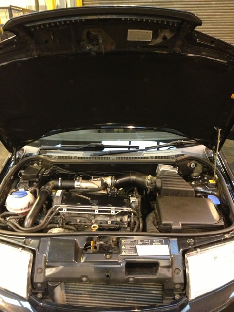

Cheers man, mines got 60k so we'll see! Erm well when I took it off it was minging full of sludge, could of probably done with cleaning the manifold too but didn't have a gasket and I was on nightshift, I feel like its a tad smoother and Not as lumpy but this may be a placebo!
That's it fitted
Looks a good-un. And you've blocked the exhaust-feeder pipe at the manifold so all good.
The shudder is definitely more pronounced but doubt the engine mounts will be trounced because of it. They have to put up with the diesel lump in the first place so are likely to be fairly tough.
I think the throttle response is better. Its noticeable enough to me so I'm happy and now have some red silicone under the bonnet to match the car.
