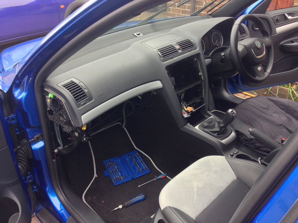

After spend today doing this:
I now have an airbag fault light up and assume this is due to not disconnecting the battery :( something I have previously experienced problems with.
