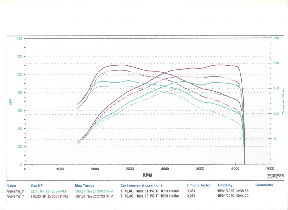

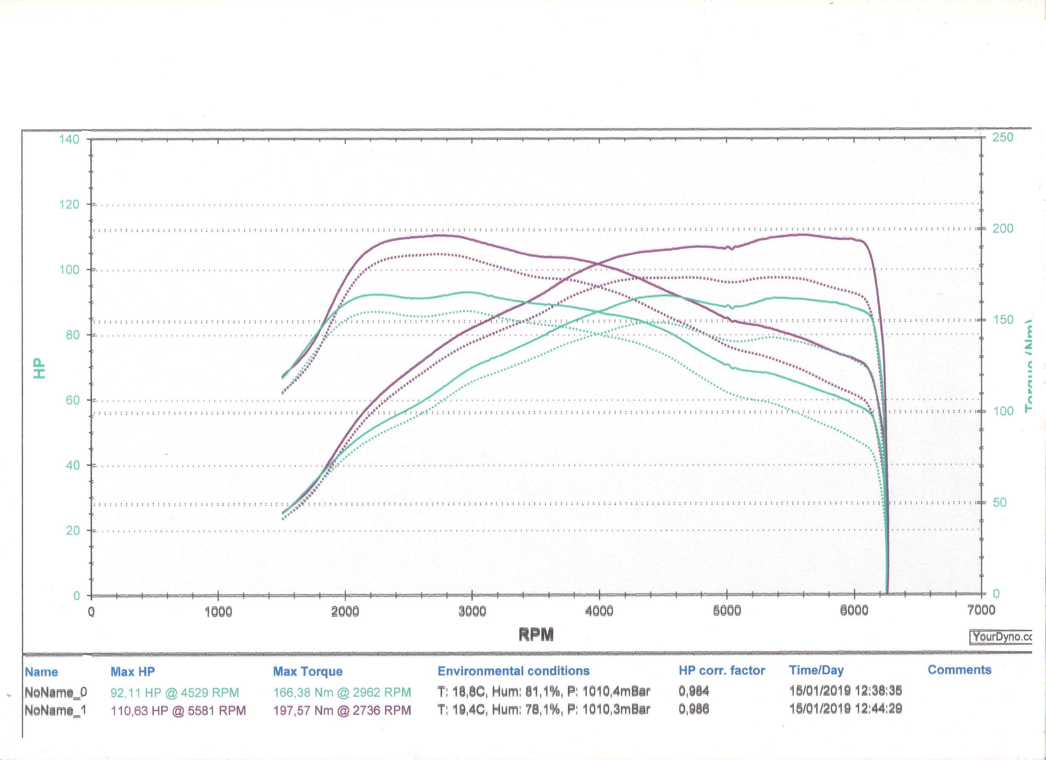

Hi there, this is my 1.2 86hp running a TMC Box on setting 9.
Engine mods:
vrs intake with the box mod
First run is stock, second is with the box, ignore the dotted graphs
