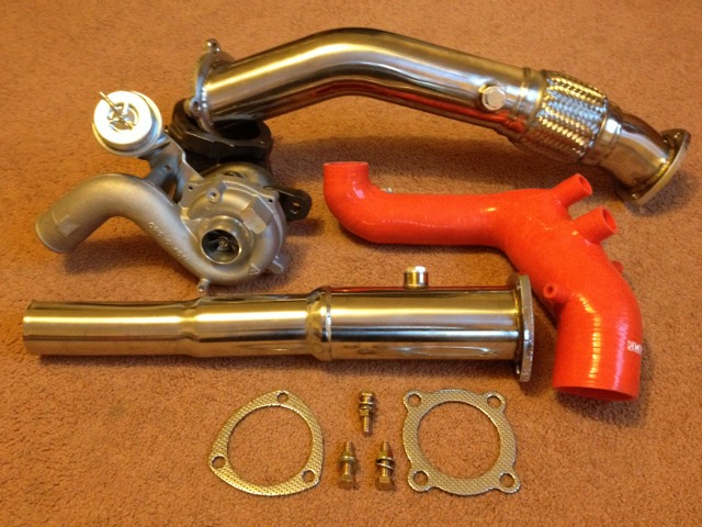

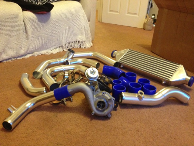

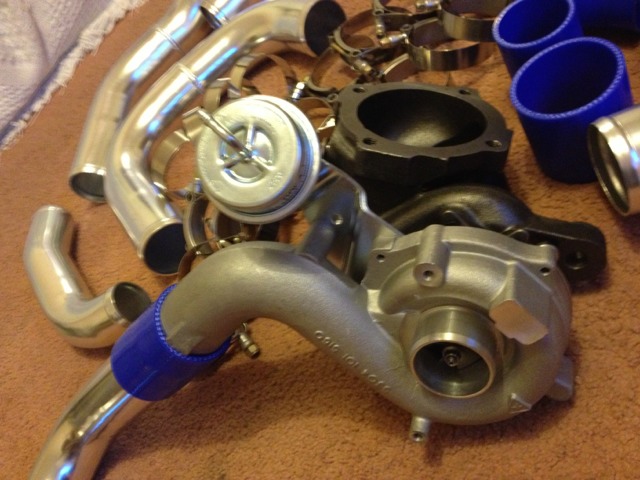

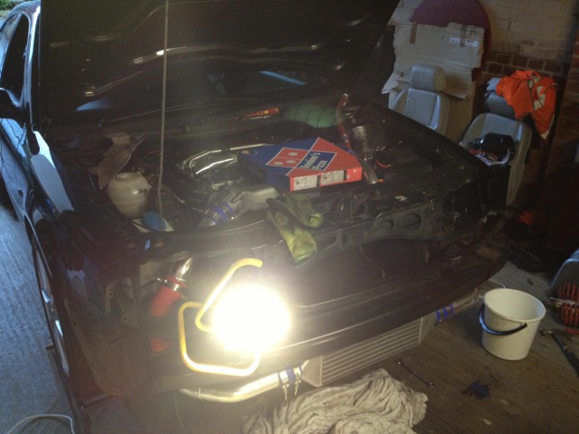

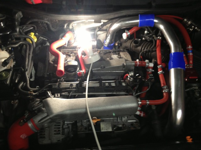

So that's a K04-001 turbo, FMIC kit, TIP, Downpipe and De-Cat and although not pictured as they had been fitted a new DV and silicone boost hose kit - although most of which was replaced when fitting the FMIC, so a tip for those who are planning on fitting an intercooler, don't waste your money on the silicone hose sets as you won't need any of it!

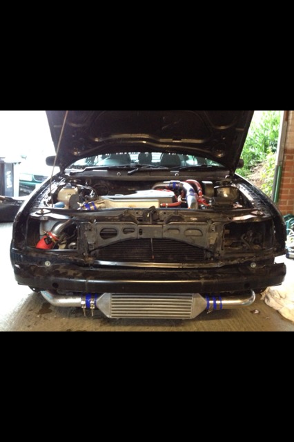

Next there are a few fitting pics, a home made lamp that scarred me for life and a dominos pizza that spurred on the 23 hour straight stint of fitting everything!

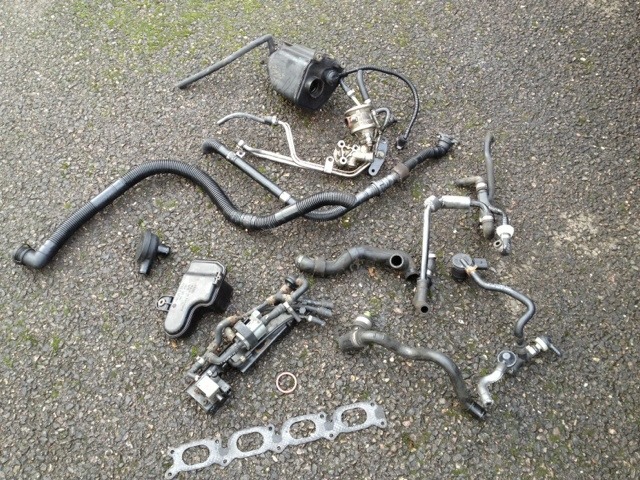

For the second part really was cleaning up a few other bits, I deleted the SAI pump, N249 and EVAP system, all of which actually made quite a difference to the way that the car runs, it made it a lot smoother and more responsive, so I've seen many threads on here questioning if it works etc or causes faults and the answer is.....
Yes, it causes the occasional EML light, but as long as you have the fault code reader it's nothing that can't be reset, mainly the EVAP system incorrect flow code when sat in traffic, it does has a negative effect on the emissions too, so remember this before pulling it all apart. I.e. keep the parts!
So all of which you can see in the picture has now been replaced by an oil catch tank and forge blanking plate.

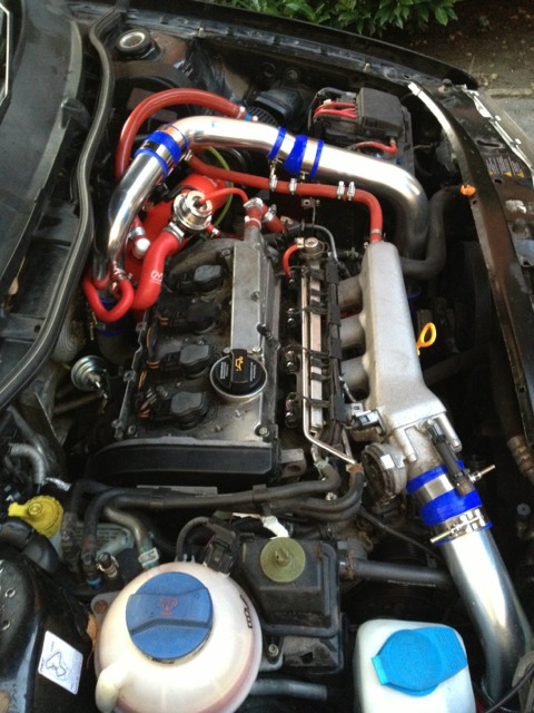

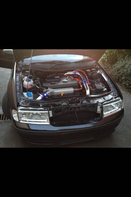

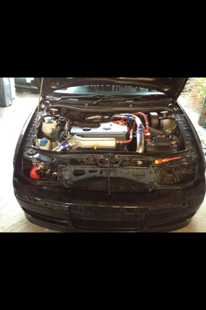

That's just a last few pictures of the engine bay and a few other tweaks, so the full spec list is below:

And bowders, in answer to your question the K04's been brilliant, it's just a cheap Chinese one but has been bulletproof. As for HP figures I'm unsure as the mapping was done before I fit all these bits, but as a reflection of speed it's quicker than the new Megane GT - which is 260bhp I think and only a nose away from keeping up with the new focus RS, I'm not going to be unrealistic and say its transformed it into a super car but for just a few quid it's a cheap bolt on mod - obviously backed up by the FMIC and TIP etc
It certainly boosts a tiny bit lower than the K03's but more importantly holds its power for a long longer into the rev range, I think the K03's and the K04 probably peak about the same (at a guess) but the K04 keeps its so much longer, making the power a lot more useable.

engine bay looks really good :happy:
My engine bay looks like the inside of a party popper, no thought was ever spent on the looks, it's only plus side is that it's crammed with goodies lol! I even had to hack away at the engine cover to allow it to fit back on. I discovered one huge benefit of owning an octavia too, unlike the golf and bora's who have the intercooler pipes hanging out of the vents in the bumper, the Octavias long nose meant I could keep it all hidden!
