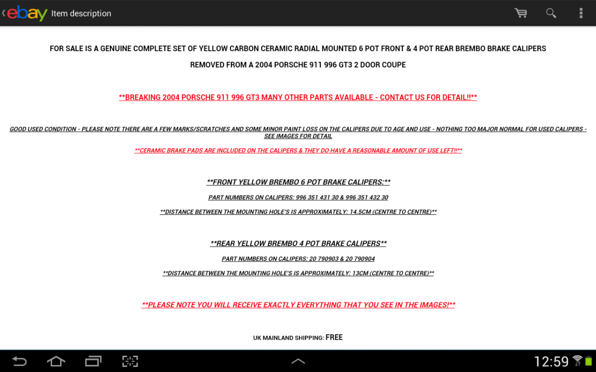

Am I correct that these will not fit? See screen shot below.
you can *make* anything fit but its going to be difficult if you're the trailblazer - for those ceramics you'd need to make up mounting brackets to fit the vag hubs and source some ceramic discs with the right pcd/offset, plus you'd probably find the master cylinder size won't be suitable and the brake balance is unlikely to be right on a front engined fwd car where that setup is designed for rear engined+rwd and you' need to consider if/how the skoda handbrake would work on those porsche rears... but other than that, yeah no worries!
much easier to go with something that's been proven before; daveb has done the design work and testing already for 996tt and 986/nqsbbk so much easier to go with one of those options, or go OE vag, TTRS etc. which should just bolt on:
