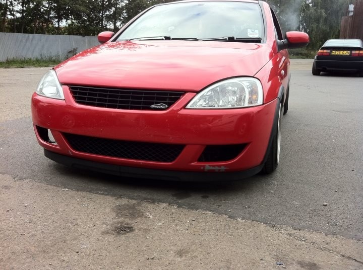

It's not a fabia but I got my old Chorsa bumper smoothed and that didn't crack at all, really Does depend on how much filler is used like Matt said.
to smooth a corsa front bumper is just smoothing the reg plate screw holes out isnt it?. . Not a massive hole like the fabia. . Ive never took much notice to the corsa front end plate mounting ect
No there is bump strips on each side as well which have a hole behind them, they needed plastic welding also
And there is the actual number plates recess itself which sits further back to the bumper I had that plastic welded then fillered so it was flush
